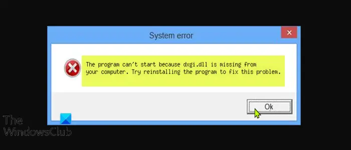

If while using or installing certain programs, performing a Windows shutdown or booting Windows, or maybe even during a Windows installation, and you encounter the error message The program can’t start because dxgi.dll is missing from your computer, then this post is intended to help you speedily fix the issue. Some dxgi.dll errors are seen while playing certain video games like PlayerUnknown’s Battlegrounds (PUBG).
To fix dxgi.dll missing or not found error on a Windows computer, you can try our recommended solutions below in no particular order and see if that helps to resolve the issue.
