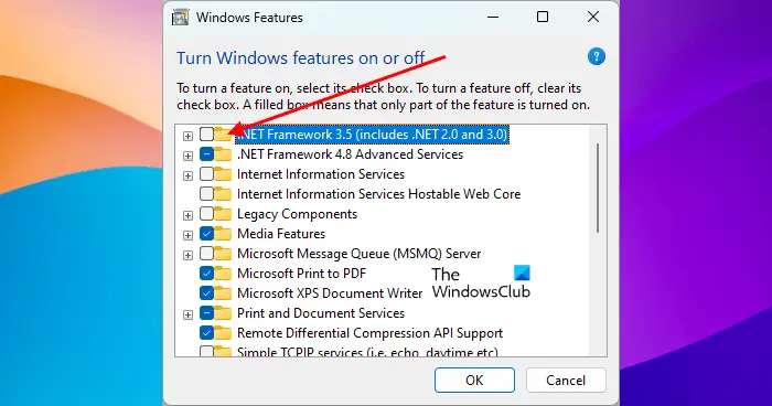

1] Turn Windows Features on or off
This is the easiest fix. Sometimes, the incorrect installation shows errors. Therefore, we suggest you toggle Microsoft .NET Framework 3.5 via Windows Features and see what happens. The steps to do this are provided below:
- Open the Control Panel.
- Go to “Programs > Programs and Features.”
- Click on the “Turn Windows features on or off” on the left side.
- Deselect .NET Framework 3.5 (if it is selected) and click OK.
- Now, restart your computer and repeat the above three steps.
- Select the .NET Framework 3.5 and click OK.
The above steps will uninstall and reinstall Microsoft .NET Framework 3.5. See if the same error occurs this time or not.

2] Uninstall Microsoft .NET Framework 4.6 or higher
According to the reports, Microsoft .NET Framework 4.6 was found to interrupt the installation of .NET Framework 3.5. If you have installed Microsoft .NET Framework 4.6 or higher, uninstall it and then try again. You can do so via the Windows Features. Go through the following instructions:
- Open the Windows Features by following the steps provided in the previous fix.
- Once the Windows Features opens up, deselect the .NET Framework 4.6 Advanced Services checkbox. If you see a .NET Framework version higher than 4.6, deselect it.
- Click OK.
The above steps will uninstall Microsoft .NET Framework 4.6 or higher version from your computer. After uninstalling it, restart your computer and then install .NET Framework 3.5. It should work.
When the .NET Framework 3.5 gets installed, you can reinstall .NET Framework 4.6 or higher via the Windows Features.
