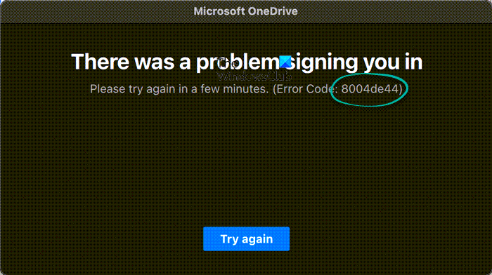

OneDrive error 0x8004de44 occurs when users try to log in to their OneDrive accounts, however, they are unsuccessful in their attempts. And this generally happens due to server issues or problems in accessing files and folders in OneDrive. In this article, we will see how to fix 0x8004de44 when encountering it.
The full error messages go as:
There was a problem signing you in. Please try again in a few minutes ( Error code:8004de44)
Fix OneDrive error 0x8004de44
If the OneDrive error 0x8004de44 keeps appearing on the screen, stopping you from logging in, execute the solutions mentioned below:
