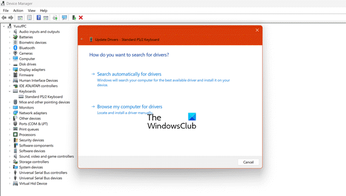

4] Reinstall your keyboard driver
You will likely face such keyboard issues if your keyboard driver is faulty or corrupted. Hence, you can reset your keyboard by uninstalling and reinstalling your keyboard drivers to fix the issue. Here’s how:
- First, press Win+X and choose Device Manager from the appeared shortcut menu.
- Next, expand the Keyboards category and right-click on your keyboard device.
- Now, choose the Uninstall device option from the context menu.
- After that, follow the prompted instructions to complete uninstallation.
- Once done, restart your PC and let Windows reinstall the missing keyboard driver.
- Check if the problem is now resolved.
It could also be your outdated keyboard drivers causing the issue. Hence, try updating your keyboard driver and check if the problem is resolved.

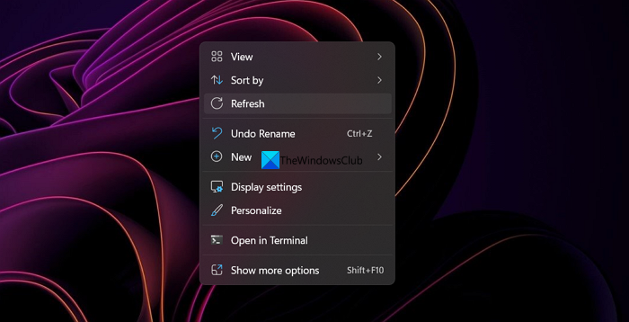

5] How do I refresh my laptop if F5 is not working?
If the F5 key is still not working, you can use an alternate method to refresh your PC. Here are those methods:
- Use CTRL+R keyboard shortcut to refresh the page.
- You can refresh your PC or page using the right-click context menu. Right-click on it and choose the Refresh option.
