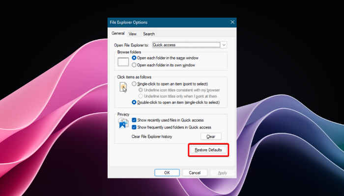

3] Restore File Explorer Options to default settings
In some cases, misconfigured settings in File Explorer may cause the desktop refresh option to not work properly. In this case, it’s recommended to restore the File Explorer options to default to reset all settings.
So, for this, open the Run console (Win + R), type in control.exe folders, and hit Enter to File Explorer Options window.
Here, under the General tab, click on the Restore Defaults button at the bottom.

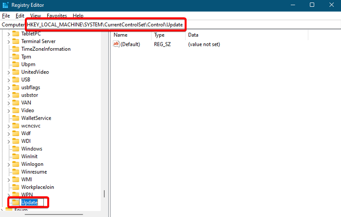

4] Modify the Registry entry
If the desktop refresh option is still not working, modifying certain registry entries can help you fix the issue. However, before you make any changes to the registry editor, make sure to create a backup of the settings. This will help you recover any lost settings in the future.
Now, open the registry editor, and navigate to the below path:
Computer\HKEY_LOCAL_MACHINE\SYSTEM\CurrentControlSet\Control
Now, right-click on the Control key > New > Key.
Rename the new key as Update.
Next, navigate the right, right-click on an empty area, select New and then click on DWORD (32-bit) Value.
Rename this value as UpdateMode. Double-click on this value to open the Edit DWORD (32-bit) Value dialog box.
Here, set the Value data field to 0. Press OK to save the changes.
Now, exit the Registry Editor and restart your PC for the changes to be effective.

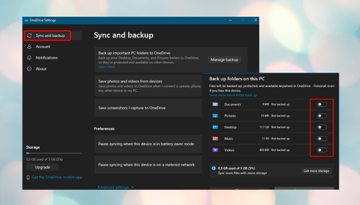

6] Turn off Onedrive backup settings temporarily
If you are using OneDrive on your PC, that could sometimes interfere with the Desktop refresh function, therefore causing the issue. Hence, we advise you to disconnect OneDrive temporarily to check if this is causing the refresh option not to work properly.
For this, open OneDrive > gear icon > Settings > Sync and backup > Mange backup > Backup folders on this PC.
Now, turn off back up for all folders and press Save changes.
