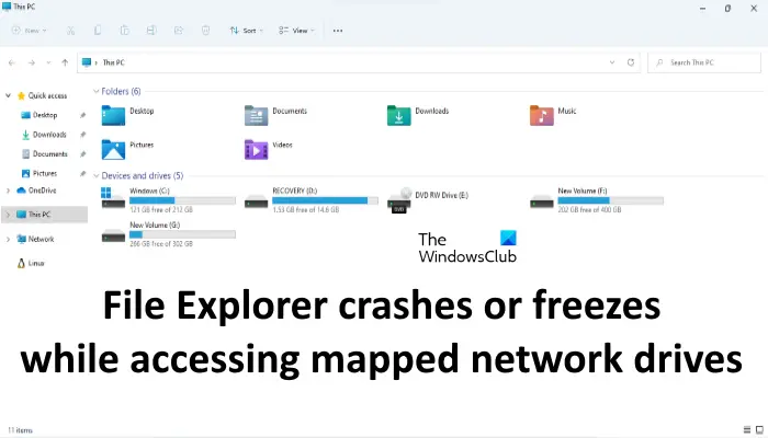

If File Explorer crashes or freezes while accessing Mapped Network Drives on your Windows 11/10 system, this post may help you fix it. At times, you may see error code c0000374. This issue prevents users from accessing the data inside the mapped network drives because every time users try to access them, File Explorer either freezes for a long time or crashes.

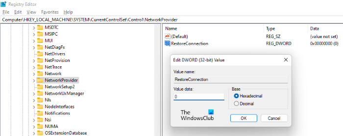

10] Create a new Value in Windows Registry
Another method to fix this issue is to create a new Value in Windows Registry. We have listed the instructions for this below. But before you proceed, it is better if you create a backup of the Registry so that you can restore it if any problem occurs.
1] Press Win + R hotkeys to launch the Run command box. Type regedit and click OK. Click Yes if you receive a UAC prompt message.
2] In the Registry Editor, copy the following path, paste it into its address bar, and hit Enter:
HKEY_LOCAL_MACHINE\SYSTEM\CurrentControlSet\Control\NetworkProvider
3] Make sure that you have selected the NetworkProvider key on the left side. Now, right-click on the right side and go to “New > DWORD (32-bit) Value.” Name this newly created Value RestoreConnection. Now, double-click on it and set its Value Data to 0.
This has helped many.

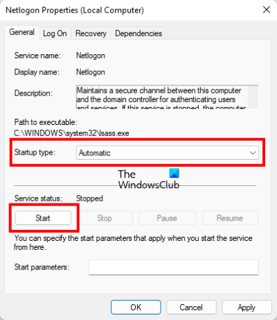

How to fix Can’t reconnect to all network drives
When Windows is unable to reconnect all network drives, it displays the following error message:
Could not reconnect all network drives. Click here to check the status of your network drives.
Such an error occurs when the Netlogon service is disabled. Hence, to fix this error, you have to enable this service on Windows OS. The steps for the same are listed below:
- Press Win + R hotkeys to launch the Run command box. Type
services.mscand click OK. - Scroll down the list of services and find Netlogon.
- Once you find it, double-click on it to open its properties.
- In the properties window, select Automatic in the Startup type drop-down menu.
- Now, click on the Start button.
- After Service starts, click Apply and then OK.
Hope this article helped you fix the error.
