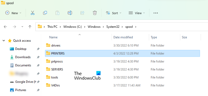

4] Clear print queue
Clear the print queue and see if you can print your document. For this, open Windows Services Manager and locate the Print Spooler service. Right-click on the Print Spooler service and select Stop. After that, go to the following location in File Explorer:
C:\Windows\System32\Spool
Open the PRINTERS folder and delete all files inside it. Now, open the Services Manager again, right-click on the Print Spooler service, and select Start.
