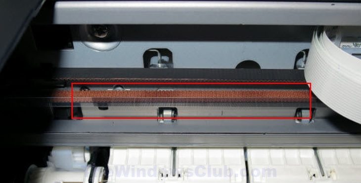

- Dirty Encoder Strips: Encoder strips are plastic strips that help the print carriage keep track of its position while it moves along the carriage rod during the print operation. Encoder Strip also sends the signal to activate the print heads while initiating the print operation. An unclean encoder strip may not judge the print position perfectly, resulting in double printing.

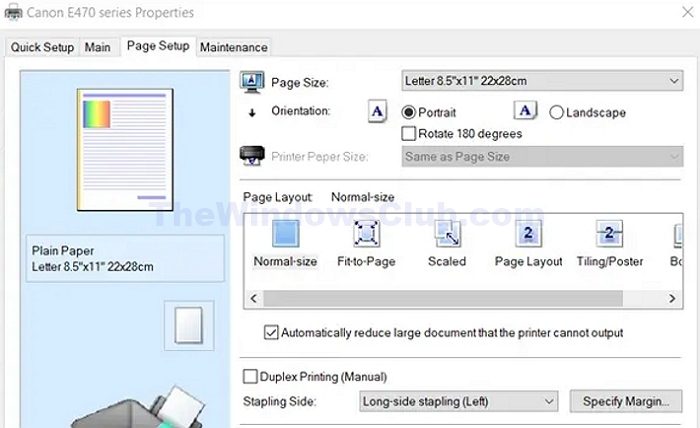

1] Check Printer Settings
Since printer settings are directly responsible for the type and quality of the print, checking them to ensure that they are in order can help us correct print quality problems. Bidirectional support allows the printer to print in both directions. However, it may cause double-vision printing if print heads are incorrectly calibrated or misaligned.
To check the printer settings:

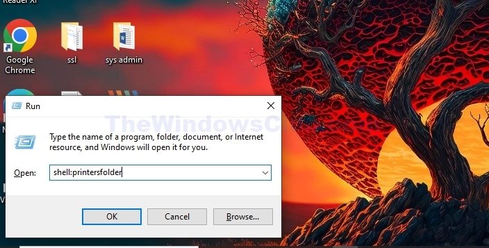

- Press the Windows + R keys together to open the Run dialogue box. Type in shell:Printersfolder before clicking on OK.
- Right-click on the printer icon and click on Properties.
- Check whether the settings related to paper size, type, and print quality are correctly configured under Page Setup.

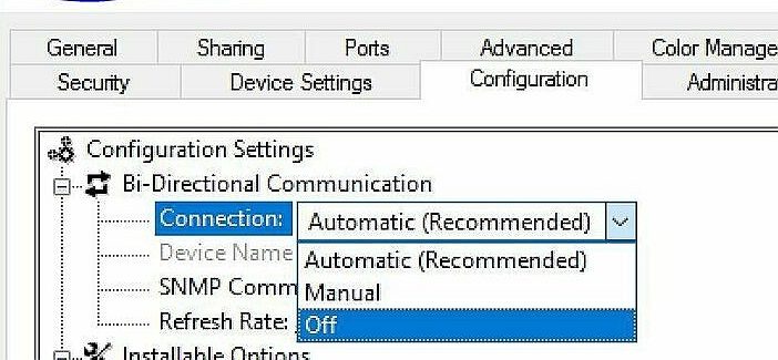

To disable Bi-directional printing:
- Right-click on the Printer icon and click on Printing Preferences
- In the Printing Preferences window, click on the Ports tab, and then select the OFF option in the drop-down menu under Bi-directional Communication.

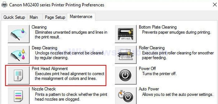

3] Recalibrate printer heads
Recalibrating or realigning the printer can help us ensure that the print heads are positioned perfectly, helping us avoid print quality errors. To align the printer:
- Right-click on the printer and click on Printing Preferences after opening the printer’s folder
- Click on the Maintenance tab and click to choose Print Head Alignment (interface or options may vary with make and model).
4] Clean Encoder Strip
Cleaning the encoder strip allows it to position as well as move the print carriage properly by following the below-mentioned steps:
- Power off the printer.
- Open the printer lid to locate the encoder strip parallel to the print head.
- Use a soft, dampened cloth or paper towel and rub it gently on the strip to clean it.
- Allow the strip to dry up completely, and then shut the lid and power on the printer.
- Once done, try printing a document to check if the error has been resolved or not.
