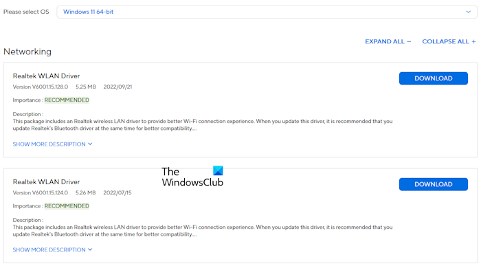

3] Update or reinstall the network adapter
One possible cause of this problem is the corrupt network adapter. Reinstalling the network driver can help. Follow the steps provided below:
- Open the Device Manager.
- Expand the Network adapters branch.
- Right-click on your network adapter and select Uninstall device.
- Restart your computer.
Windows will automatically install the missing driver on restart. If this does not help, download the latest version of your network driver from the official website of your computer manufacturer and install it manually.

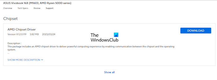

5] Update BIOS and chipset driver
A BIOS update improves hardware compatibility and system stability, so it is necessary. Check if a BIOS update is available. Visit the official website of your computer’s manufacturer and check if a BIOS update is available. If yes, download and install the update.
Note that your computer should have a continuous power supply during the BIOS update process. If you have a laptop, connect it to the charger during the BIOS update even if it is fully charged. Interrupting the power supply during the BIOS update can damage the motherboard. You can check the current version of the BIOS in the System Information app of Windows 11/10.
I also suggest you update the chipset driver to the latest version. You can download its latest version from your computer manufacturer’s official website.
