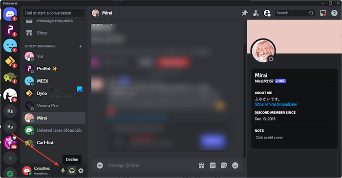

3] Ensure you are not on mute on Discord
Discord provides two features namely Mute and Deafen. If you have enabled the Mute feature, you won’t be heard by others on a channel even while streaming. The Deafen feature stops you from listening to others on a server and will put you on mute. Now, if you have enabled any of these features, disable them and then check if the problem is resolved.

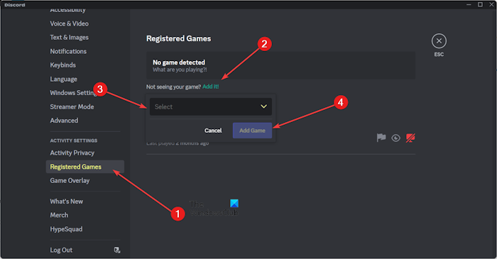

6] Add your game or application on Discord
Discord automatically detects the playing game when you are streaming. However, if it is having issues doing that, you can manually add your game or app for detection on Discord to fix the issue. Here’s how to do that:
- First, click on the User Settings button in Discord.
- Now, scroll down to the ACTIVITY SETTINGS section and click on Registered Games.
- After that, tap on the Add it! link and then select the target game or app.
- Next, press the Add Game button and then exit the Settings window.
- Finally, see if the audio issues on Discord streams are resolved now.

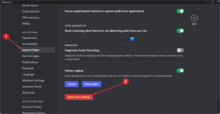

7] Reset voice settings on Discord
It could be your voice settings causing problems in streams on Discord. Hence, if the scenario is applicable, you can reset the voice settings to their defaults to fix the problem. Here are the steps to do that:
- First, open Discord and tap on the User Settings button.
- Now, go to the APP SETTINGS section and press the Voice & Video option.
- After that, scroll down to the end of the page and click on the Reset Voice Settings button.
- Next, press the Okay button in the confirmation prompt and when done, check if the issue is resolved.
