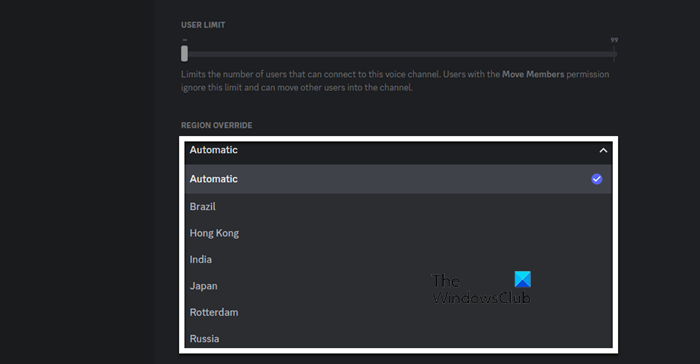

2] Change Channel region
There are high chances of an increase in latency if you are not using the channel closest to you. Apart from this, our channel server can also face some issues, and hence the videos may lag. In such circumstances, we can change the channel region, and here’s how to do so:
- Launch Discord and navigate to the server.
- Click on the gear icon present beside the voice channel.
- In the Overview tab, scroll down to reach Region Override.
- Use the drop-down menu to select a different server.
- Select the Save button to save the change.
Now, stream the videos and check for lagging.

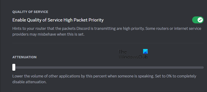

4] Enable Quality of service
If your router is not prioritizing Discord’s packet as it should, lagging in streaming will be the end result. To avoid this situation, enabling the Quality of a service option from Voice and Video settings is the right choice and that’s what we are going to do:
- Launch Discord and click on the gear/cogwheel icon present in the bottom-left corner.
- Next, scroll down to App Settings and select Voice & Video.
- Scroll down to find Quality of Service and enable the Enable Quality of Service High Packet Priority option.
After doing this, relaunch Discord and start the streaming.
