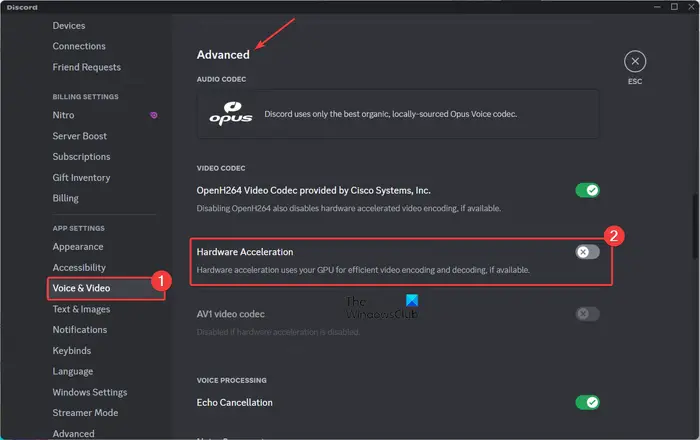

6] Turn off Hardware Acceleration on Discord
Hardware acceleration is a handy feature that allows Discord to utilize your GPU to the fullest and speed up tasks like video encoding/decoding. However, this feature can also cause several errors and problems in the regular working of the app as it might overwhelm your system resources.
Now, if you are facing this problem after enabling the Hardware Acceleration function on Discord, consider disabling it and then check if the problem is fixed. Here are the steps you can use to do that:
- First, open the Discord app and click on the User Settings button from the bottom of its window.
- Now, go to the Voice and Video option and scroll down to the Advanced section at the right-side pane.
- Next, switch off the toggle associated with the Hardware Acceleration option.
- Finally, relaunch Discord and hopefully, the app won’t restart automatically.
