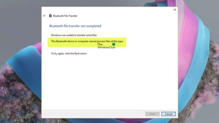

For some PC users, you may be unable to transfer files via Bluetooth to your Windows 11 or Windows 10 PC from your mobile phone/device or vice-versa with the Bluetooth File Transfer wizard displaying the message This Bluetooth device or computer cannot process files of this type. This post provides easy solutions and workarounds to this issue.
Bluetooth file transfer not completed, Windows was unable to transfer some files, This Bluetooth device or computer cannot process files of this type.
If the Bluetooth File Transfer wizard displays a message stating This Bluetooth device or computer cannot process files of this type when you try to transfer any file type from your mobile phone/device to your Windows 11/10 PC or from your PC to your mobile device/phone, then our suggestions/workarounds as provided below in no particular order are intended to help you resolve the issue so that you can Send or Receive files using Bluetooth File Transfer.

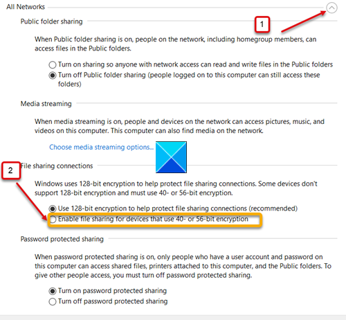

1] Enable file sharing for devices that use encryption
To help protect file-sharing connections, by default, Windows uses 128-bit encryption. But some devices don’t support 128-bit encryption and must use 40 or 56-bit encryption. Since you’re getting the error message This Bluetooth device or computer cannot process files of this type between your mobile phone and Windows PC, the encryption mode in use could be the culprit. So, to rule out this as a potential culprit, you can enable file sharing for devices that use encryption by following these steps:
- Open Control Panel.
- Go to Network & Sharing Center.
- Click on the Change advanced Sharing Settings link.
- Click the All Networks drop-down menu.
- Next, scroll down to the File sharing connections heading.
- Now, click to select the radio button for the option Enable file sharing for devices that use 40 or 56-bit encryption.
- Click the Save changes button and exit.
Now, you can try connecting the two devices again. You should be able to send files from your PC via Bluetooth to your Android phone.

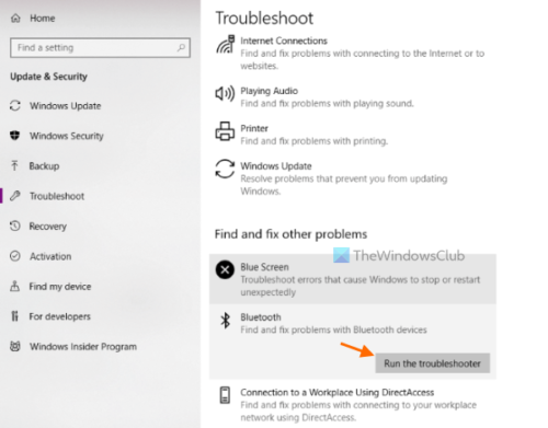

2] Run the Bluetooth Troubleshooter
This solution requires you to run the inbuilt Bluetooth Troubleshooter on your PC and see if that helps resolve the issue you’re currently grappling with.

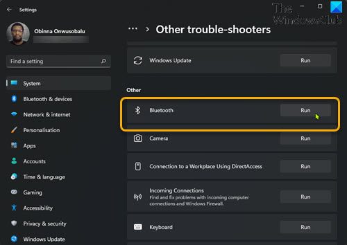

To run the Bluetooth Troubleshooter on your Windows 11 device, do the following:
- Press the Windows key + I to open the Settings app.
- Under the Other section, find Bluetooth.
- Click the Run button.
To run the Bluetooth Troubleshooter on your Windows 10 PC, do the following:
- Go to Update and Security.
- Scroll down and click on Bluetooth.
You may have to reset the Bluetooth adapter if need be. Proceed with the next suggestion if the issue persists.
