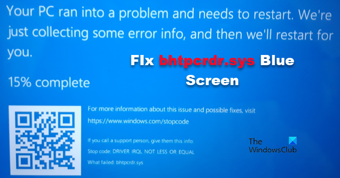

After updating to the latest version of Windows, we have noticed bhtpcrdr.sys Blue Screen error. This is extremely frustrating especially because most users don’t know what bhtpcrdr.sys file is. This post will discuss this issue and see how you can resolve it.
The bhtpcrdr.sys file is a card reader driver and is related to O2Micro SD Reader Driver from BayHubTech/O2Micro. The file is located in the \%Windir%\%System%\drivers\ directory. This bug check indicates that a system thread generated an exception which the error handler did not catch. This appears to be a typical software driver bug and is not likely to be caused by a hardware problem.
The accompanying error messages you may see are:
- Internal_Power_Error
- DRIVER_IRQL_NOT_LESS_OR_EQUAL
- System_Thread_Exception_Not_Handled

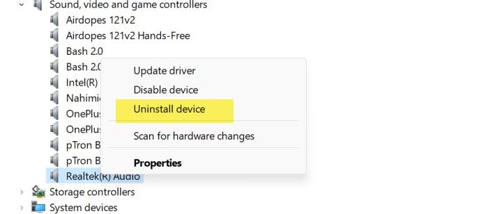

3] Uninstall & reinstall the device driver
Some users reported that after uninstalling the driver via Control Panel > Programs > Uninstall a program, the driver is still present in the system after restart. So, to carry out an invasive uninstall of the driver, do the following:
- In the Run dialog box, type
devmgmt.mscand hit Enter to open Device Manager. - Once you’re inside Device Manager, scroll down through the list of installed devices and expand the Storage controllers section.
- Right-click BayHubTech Integrated MMC/SD Controller and select Uninstall device.
Once done, restart and install the latest driver and check.
