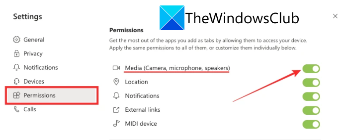

5] Enable Media Permissions on Teams
You also need to make sure that the media permissions on Teams are enabled. To do that, here are the steps to follow:
- First, press the Settings and more button and then go to the Settings > Devices option.
- Now, make sure the toggle associated with the Media (Camera, microphone, speakers) option is enabled.
- Next, go back to Teams meetings or calls and see if the audio is working fine.
If this method doesn’t help, move on to the next potential fix to resolve it.

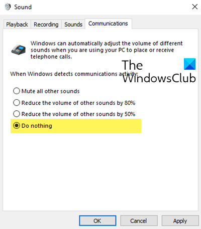

How to fix Low sound in Teams?
To fix Low sound in Teams, go to your system’s sound settings, find your Sound Control Panel, select Communications and then Do nothing. Finally, apply the changes so others will be able to hear your shared audio loud and clear.
