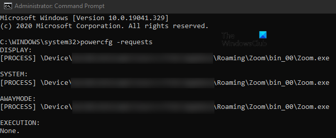

6] Run a /requestoverride command for the Zoom app
As explained previously in this article, incorrect Power Availability Requests from an app interfere with a system’s power management and automatic sleep behaviors. This may lead to several issues. To fix such a problem, you can execute the /requestoverride or -requestoverride command. In your case, the issue might also be occurring due to the incorrect Power Availability Requests sent by the Zoom app.
The powercfg /requestsoverride or powercfg -requestsoverride command has the following structure:
powercfg -requestsoverride <CALLER_TYPE> “<NAME>” <REQUEST>
From the above structure, it is clear that you should know the Caller type, Name, and Request to execute the /requestsoverride command. For this, first, execute the following command in an elevated Command Prompt:
powercfg -requests
The result of the powercfg -requests command will let you know the Caller Type, Name, and Request for the Zoom app. For example, in the above screenshot, the caller type is the [Process], caller id is zoom.exe, and the requests are Display, System, and Awaymode. If you find more than one request for the Zoom app, you need to execute the above command separately for each request one by one.
Hence, in this case, the commands to be executed are:
powercfg -requestsoverride PROCESS “Zoom.exe” AWAYMODE
powercfg -requestsoverride PROCESS “Zoom.exe” SYSTEM
powercfg -requestsoverride PROCESS “Zoom.exe” DISPLAY

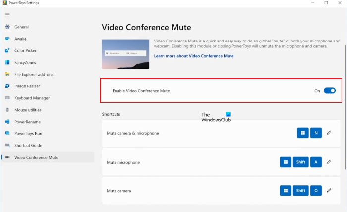

3] Disable PowerToys Video Conference Mute mode
Many users have found the PowerToys Video Conference Mute mode conflicting with the Zoom app, causing it to crash on Windows laptops. If you have installed PowerToys on your system, disable its Video Conference Mute mode and check if it helps.
The following steps will help you with that:
- Launch PowerToys.
- Go to its Settings.
- Select Video Conference Mute from the felt side.
- Turn off the button next to Enable Video Conference Mute.
