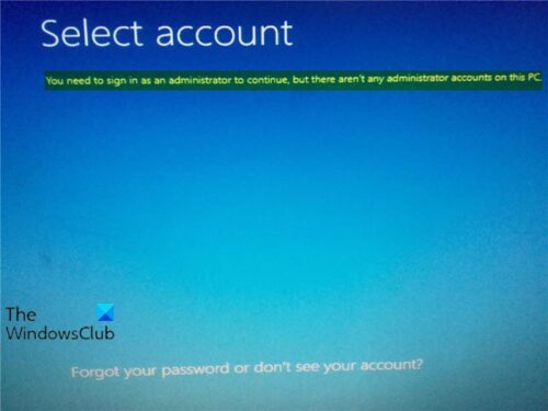

If you have encountered the error message You need to sign in as an administrator to continue, but there aren’t any administrator accounts on this PC, it’s probably why you have landed on this page. In this post, we will provide the most suitable solutions you can try to resolve this issue successfully.
You may encounter the issue whereby your Windows device fails to start and when you try to access Advanced Startup Options, you’re stuck on the error message screen even if you hard reboot your device. You may see this error when accessing Startup Repair, using System Restore or CMD, selecting an account in WinRe and so on.
If you’re faced with this issue, try our recommended solutions below in the order presented below and see if any of the four methods help you resolve the issue.
