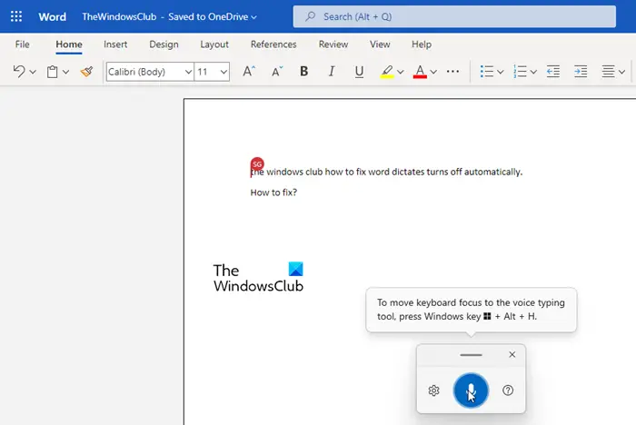

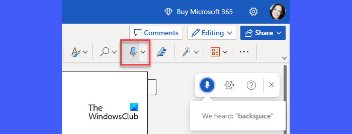

If Word Dictate keeps turning off on a Windows 11/10 PC, here are some suggestions to help you fix the issue. A few Windows users have reported that they are facing an issue where the dictate feature stops working or keeps turning off in Microsoft Word. Dictate is a Microsoft tool designed to make it easier for users to create content using a microphone. It uses speech-to-text conversion technology to quickly put a user’s thoughts into words without the need to type them out. However, sometimes, the tool doesn’t work as expected.
It can be frustrating when Word Dictate stops working when you’re in the middle of something important. In this post, we will show you how to fix Word Dictate keeps turning off in Windows 11/10.

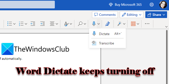

Dictatate gets functional only for a couple of seconds and turns off automatically if there’s a gap or silence in your speech. Dictate is designed that way and this is not a bug. You can’t fix this and keep Dictate functional until you command it to stop. However, if Dictate turns off in the middle of a sentence without any warning, there must be some internal issue that needs to be resolved.

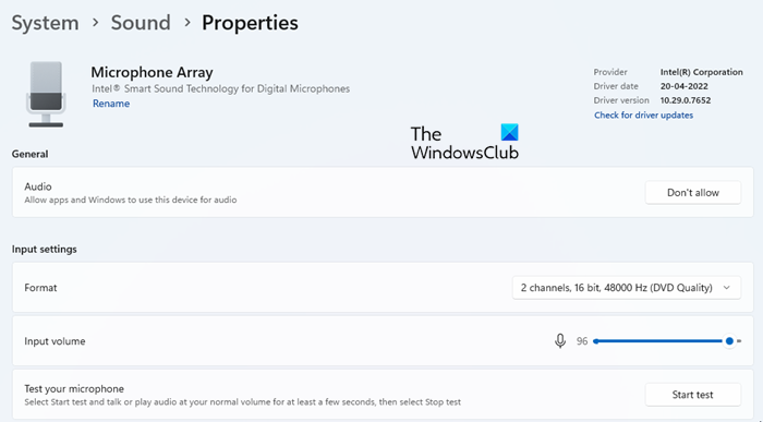

1] Adjust the microphone volume
If your microphone volume is set to low, it may not be able to hear your voice properly. In such a case, Word Dictate may turn off if it senses a gap in between.
- Click on the Start menu icon in the Windows taskbar.
- Click on the Settings option.
- Click on the Sounds option under System settings.
- Scroll down to the Input section and click on the device name you’ve paired for speaking or recording on your Windows PC.
- Under the Input Settings section, move the Input Volume slider to the right to increase the volume of your microphone.
