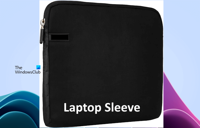

2] How do you put your laptop after putting it to sleep mode?
It also depends on how you put your laptop after putting it to sleep mode. The sleep mode puts the laptop in a low-power state. The fans also spin in the sleep mode but at a lower speed. It will overheat if you do not provide proper ventilation to your laptop after putting it into sleep mode.
Please do not put your laptop in a sleeve or bag after sleeping because improper ventilation can cause it to overheat. If you do so, it is better to shut it down rather than sleep.
