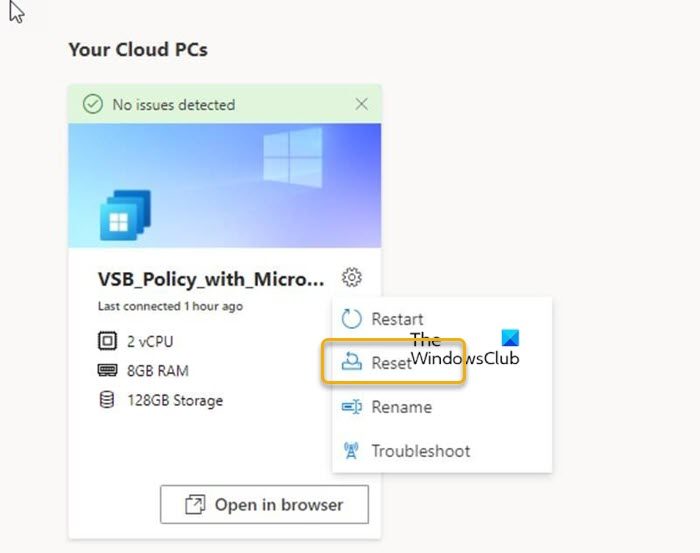

2] Reset your Cloud PCs
Now, after you complete the troubleshooting steps outlined above, all users that received the Setup failed error are required to restart/reset their Cloud PC setup by following these steps:
- On the Windows 365 home page, select the gear icon for any Cloud PC with the Setup failed status.
- Select Reset to restart the setup process.
If after the reset, the “Setup failed” error is still shown, you will have to complete the step above (if you skipped it) that requires you to make sure the Mobility (MDM and MAM) settings are correctly configured, then reset the Cloud PC again. Otherwise, in the left navigation pane, select New support request to open a support ticket.
