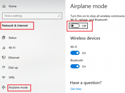

4] Turn OFF Airplane mode through System Settings
If you are unable to turn OFF the Airplane mode through the Taskbar, try doing it through the system settings.
- Search for airplane mode in the Windows search bar.
- Click on the option to open the Airplane mode settings.
- Turn the switch for the Airplane mode to OFF.
