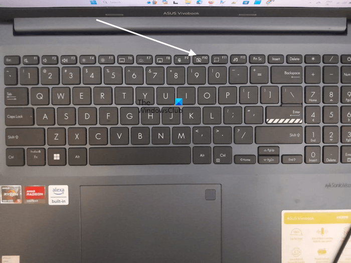

2] Make sure that the webcam is enabled
Laptops of some brands have a dedicated key to enable and disable the webcam. Check if your laptop has such a key. If yes, you might have accidentally pressed that key which disabled the webcam. For example, on my ASUS Vivobook laptop, the F10 key enables and disables the webcam. Press that key again to enable the webcam.

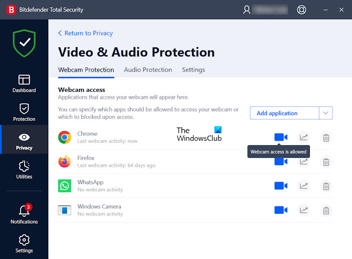

3] Temporarily disable your antivirus
Your antivirus might be blocking the access to webcam by Chrome or Edge browser. To confirm this, disable your antivirus. If your webcam starts working after disabling the antivirus, check your antivirus settings to allow your webcam access.

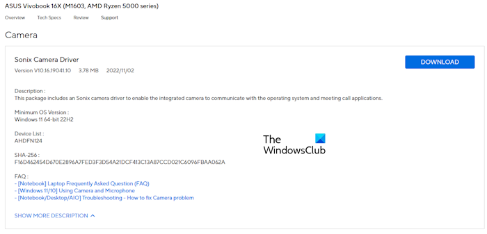

4] Reinstall your webcam driver
The problem may also be associated with the webcam driver. We suggest you uninstall and reinstall your webcam driver.
Follow the steps provided below:
- Open the Device Manager.
- Expand the Cameras branch.
- Right-click on the camera driver and select Uninstall device.
- Visit the official website of your computer manufacturer and download the latest version of your camera driver. If you have an external webcam, download its driver from its official website.
- Install the driver and restart your computer.
Now, check if the issue persists.

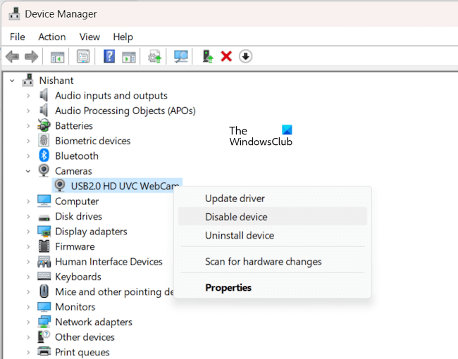

5] Disable the built-in webcam (if applicable)
If you are a laptop user and you are using an external webcam, disable your laptop’s internal webcam. To do so, disable your laptop’s webcam driver.
The following instructions will help you:
- Right-click on your webcam driver and select Disable device.

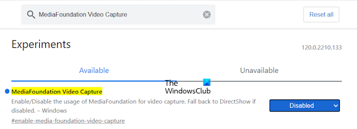

6] Disable the required flags
If the following flags are enabled in Edge or Chrome, you may experience camera issues. We suggest you check this and disable these flags (if required).
- Open Edge or Chrome.
- Visit chrome://flags in Google Chrome.
- Visit edge://flags in Microsoft Edge.
Search for the following flags one by one and disable them:
- MediaFoundation Video Capture
- Enable Zero-Copy Video Capture
Alternatively, you can also reset all the flags to default. This action will restore all the flag settings to the default values. Therefore, all the changes you have made to flags will reset.

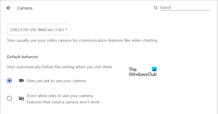

We also suggest you check the Camera permissions in Edge and Chrome. Google Chrome users can follow the following steps:
- Open Chrome Settings.
- Go to “Privacy and security > Site settings.”
- Now, select Camera.
- Your camera should be selected in the drop-down and the following option will be selected under the Default behavior section:
- Sites can ask to use your camera.
Also, check if you have blocked the website from accessing your camera in Chrome in the Computerized behavior section. If yes, delete that website.

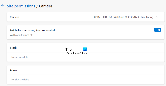

If you are using Microsoft Edge, open its Settings and go to Cookies and site permissions > Site permissions. Select Camera and make sure that the “Ask before accessing” option is turned on. Also, check if the website is blocked from accessing your camera. If yes, delete it.

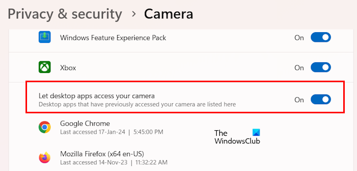

10] Check Privacy settings on your system
Windows 11/10 allows users to manage their privacy by allowing and blocking access to different apps. Check if you have accidentally disabled the Camera access to Chrome and Edge.
Go through the following instructions:
- Open your system settings.
- Go to “Privacy & security > Camera.”
- Turn on the following options:
- Camera access
- Let apps access your camera
- Now, expand the Let apps access your camera tab and scroll down to locate Chrome and Edge. Turn on the switch.
