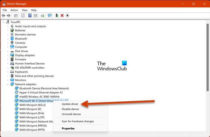

3] Select a different driver
Mobile Hotspot will fail to turn on if you have selected the driver with a bug. We don’t manually select the faulty driver, but during an update, it replaces the actual driver and causes issues. We need to switch to the driver that’s working fine in order to resolve the issue. Follow the steps mentioned below to do the same.
- Press Windows + X key and select the Device Manager.
- Select the Show hidden devices option on the View menu option.
- Expand network adapters and right-click on Microsoft Wi-Fi Direct Virtual Adapter and select Update driver on the adapter’s context menu.
- Select the Browse my computer for driver option.
- Here, select the Let me pick from a list of available drivers option, then Microsoft Hosted Network Adapter (you may have a different driver, so, just select the one other than the previously selected one), and then click on the Next button to update the driver.
Finally, close the Device Manager and check if you are able to set up Ethernet.
4] Re-enable the Microsoft Wi-Fi Direct Virtual Adapter
As soon as you enable the hotspot, a virtual adapter is added to the network connection options named Microsoft Wi-Fi Direct Virtual adapter. And this adapter provides internet to the users. But sometimes, users are not able to access the internet even if this adapter is enabled. In this case, we need to disable and then re-enable the Microsoft Wi-Fi Direct Virtual Adapter to resolve temporary glitches.
- Press Windows + R key to open the run dialog box.
- Type devmgmt.msc and press Enter button.
- Once you enter into the Device Manager, click on the View tab, and from there select Show Hidden Devices.
- Now expand the Network adapters and select Microsoft Wi-Fi Direct Virtual Adapter.
- Right-click on Microsoft Wi-Fi Direct Visual Adapter and choose Disable from the menu.
- Once it is disabled, again right-click on this Virtual adapter and select enable.
Hopefully, after disabling and enabling this adapter, the issue will be resolved.
