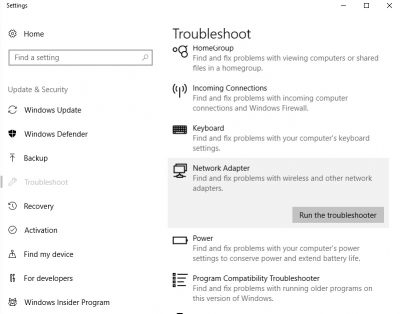

1] Run Network Adapter Troubleshooter
Windows PC comes with troubleshooters for all your issues. Check with it first and classify the exact error.
- Type Troubleshoot in the Search bar (Win + S) of your PC and open the Troubleshoot settings.
- Scroll down the right pane and select ‘Network Adapter’ and click on ‘Run Troubleshooter’.
- The PC will then start checking for possible errors and will possibly detect the issue.

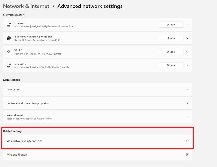

In Windows 11
- Open Settings, and navigate to Network & Internet > Advanced network settings
- Click on More network adaptor options to open the classic Network Connections.
- Right-click on the Wifi adaptor from the list and select properties.
- Switch to Sharing and check the option “Allow other network users to connect through this computer’s Internet connection”.
- Save the settings, and test if it’s working.

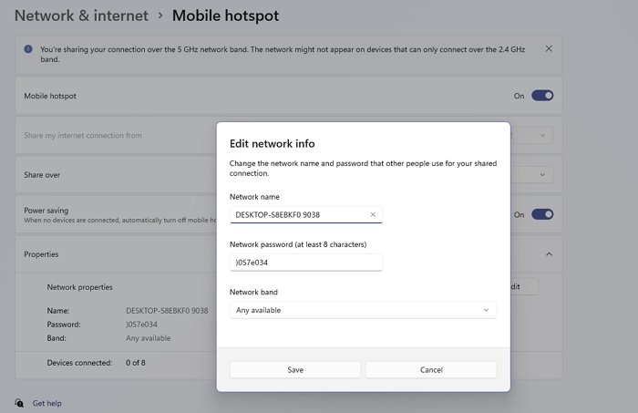

How do I reset my Windows hotspot?
Go to Windows Settings > Network & Internet > Mobile hotspot. Then expand the Properties section, and click on the Edit button. Here you can change the name of the hotspot, password, and band. Once done, click on the Save button, and it will reset the old parameters.
