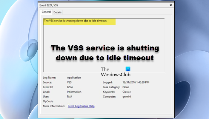

For some users, VSS aka Volume Shadow Copy Service is not running on their Windows 11/10 computers. And when they tried probing the issue in Event Viewer, they find out that the error message was The VSS service is shutting down due to idle timeout. In this article, we are going to take the investigation a step further and see what can be done to resolve the issue.
What is The VSS service is shutting down due to idle timeout error?
The error message indicates that the VSS Service is not working on your computer the way it should. There are multiple reasons for that, the most common is that the service itself is not started or starts and shuts down for some reason.
Also, the issue can occur because of corrupted system files, there are many reasons why the files got corrupted, improper shutdown is an obvious one. However, there are ways to fix corrupted system files; we are going to see a bunch of them. We are also going to look at a few other things, so let us buckle up and see how to resolve the error.

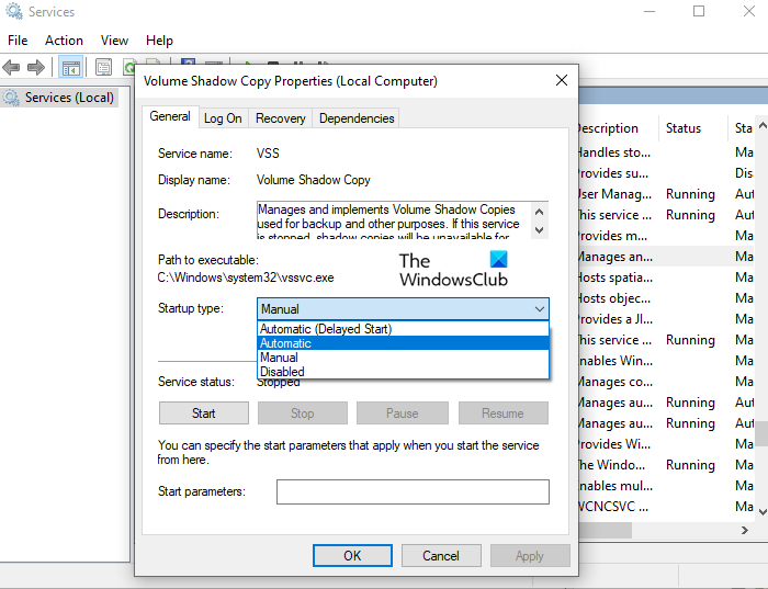

1] Configure the VSS Service
By default, the Volume Shadow Copy Service should be set to Manual. We are going to use Services Manager, which lists all the services running on your computer, to configure the service in question. So, follow the prescribed steps to do the same.
- Open Services by searching it out of the Start Menu.
- Look for Volume Shadow Copy service.
- Right-click on the service and select Properties.
- If you see it as Disabled, then change the Startup type to Manual.
- Click Apply > Ok.
Next click on the Start button to see if the Service starts.
