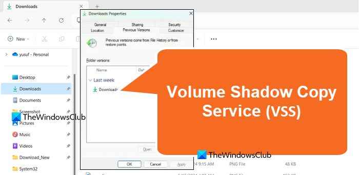

When you right-click on a folder in Windows, you get the option saying “Previous versions”. You might have used the option as well to restore the folder settings and sometimes the content to a previous state. Similarly, you know that you can use the system restore to restore your computer to a previous state. Of course, there will be a loss of some programs and changes that you made recently, but compared to the turmoil of having to get all that stuff working using manual means, restoring is pretty easy.
The VSS service is also used by third-party programs to create a disk image whenever you want. On its own, the VSS starts upon certain triggers, to create an image of the system drive and other disks/drives associated with the computer in question. If all the drive types are of the same type – i.e., NTFS, it takes a single snapshot. If the drives are of different types and maybe also from different makes or models, the VSS takes a series of snapshots for each type of drive. Be it a single snapshot or set of snapshots, they are stored in a well-protected area of your system drive and are assigned a unique ID (date-time stamp) with which, they can be used to restore the entire system drive or a folder therein, to a previous state.

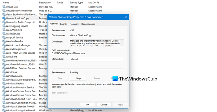

Does Windows 11 have VSS?
Yes, Windows 11 has Volume Shadow Copy Service for the point-in-time copies of volumes that can be later on restored as per the requirement. To enable the service, open the Services app, look for Volume Shadow Copy Service, and then click on Start.
