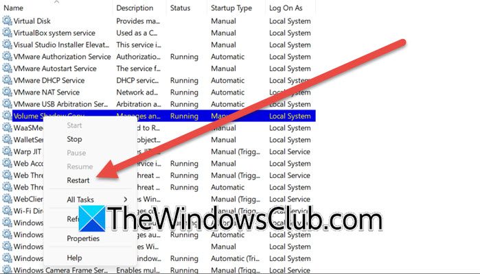

1] Restart the Volume Shadow Copy Service
First of all, we need to reboot the Volume Shadow Copy service and then retry. This is usually the first solution that one should try upon encountering an issue with shadow copied. To restart the service, you need to follow the steps mentioned below.
- Open Services.
- Look for Volume Shadow Copy, right-click on it, and select Restart.
- If the service is not running, you need to right-click on it and select Start.

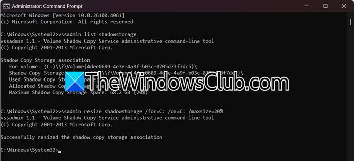

3] Manage ShadowCopy Storage (Volume Shadow Copies)
In this solution, we are going to increase the space of volume to accommodate its growth. To do so, you need to follow the steps mentioned below.
- Launch the Command Prompt as an administrator.
- Run the following command to check the current space.
vssadmin list shadowstorage
Note the Used and Allocated values to determine if adjustments are needed.
- Now, set a Reasonable Maximum Shadow Storage Limit. You need to avoid letting VSS use the entire volume. Microsoft recommends 10-20% of the volume size for most workloads.
vssadmin resize shadowstorage /for=C: /on=C: /maxsize=20%
- Clear the shadow copy.
vssadmin delete shadows /for=C: /oldest <-- Delete oldest
vssadmin delete shadows /for=C: /all <-- Delete all (use cautiously)
You need to make sure to keep at least one shadow copy; only delete all the copies if you have tried everything and nothing seems to work.
