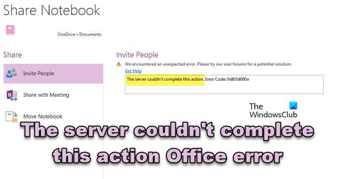

This post will show you how to ffix Error 0x803d000a, 0x88ffc009, or 0x803d0005, The server couldn’t complete the action requested in Office.
Some users cannot save files in Excel, Word, and other Office apps. Some other users reported the same issue when accessing files over a network. Both sets of users reported getting the following error message when trying to do their respective tasks.
The server couldn’t complete this action. Error Code0x88ffc009, 0x803d0005 or 0x803d000a
You may see different error codes such as 0x803d000a, 0x88ffc009, or 0x803d0005, but the solutions mentioned here apply to all since the error because of server and network issues.
Fix The server couldn’t complete this action Office error
If the server is unable to complete the action asked by the user, it is very likely that there is some issue with the network. Your network connection might be slow or laggy.
To fix The server couldn’t complete the action requested, Error 0x803d000a, 0x88ffc009, or 0x803d0005 in Office follow these suggestions:

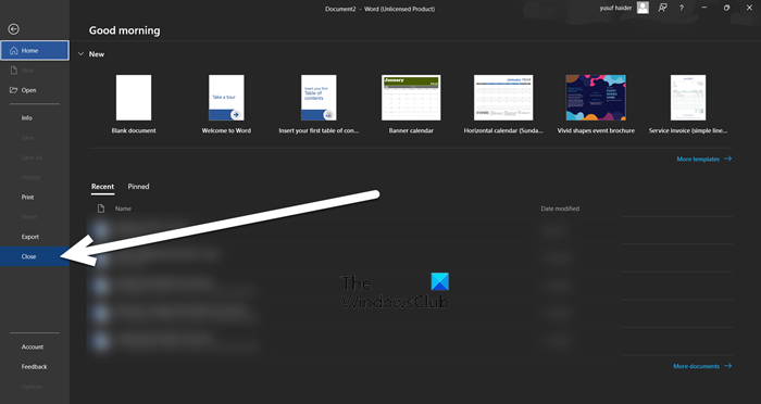

1] Restart Office App
You may encounter the error due to some technical glitch. In that case, you can close the app completely and then open it. However, if you get this error when saving a file, closing the app is not a feasible option. In that case, either save the file offline or paste the content to an alternative application, for example, for Word, Google Docs is an alternative online service. Once you are out of this dilemma, follow the steps mentioned below to restart the app.
- Close all related files.
- Choose the File option in the menu and select close to exit completely.
- Open Task Manager, look if any Office app is running, right-click on it, and select End Task.
- Wait for a while then open the program again.
Once it is restarted, go and check whether the issue will be resolved or not.
