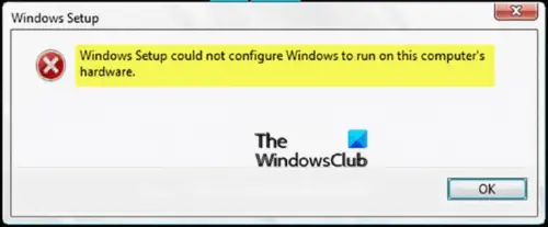

Some users when installing a Feature Update or full install/re-install of Windows 11 or Windows 10 may receive the error Windows setup could not configure Windows to run on this computer’s hardware right after or during the “Completing installation” stage of the process. The installation process will not continue past the error. If you restart the computer, the install process will return at the same error with no further progress. In this post, we will provide the solution for both cases of when performing a feature update or installing Windows 11/10 and you encounter this error.
This error can be triggered by a number of reasons, such as corrupted update installation files (especially during a major update such as the Windows 11/10 Feature Updates), an unseen problem with the Windows Update services, a Windows activation error (if you’re installing Windows 11/10), an OS system file error, or even conflicts between existing software.
Windows Setup could not configure Windows to run on this computer’s hardware
