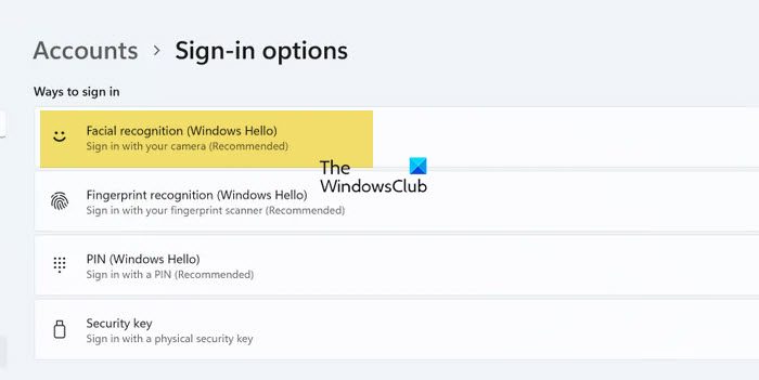

Set up facial recognition or Windows Hello
To set up facial recognition in Windows 11/10, follow the steps mentioned below.
- Go to your Settings > Accounts > Sign in options.
- Locate Windows Hello and select the Infrared camera option.
- You will see a “Welcome to Windows Hello” box with a “Get Started” button.
- Click on the button, and your system will ask you to stare at your device’s screen directly.
- While your device wills can take your image, you will notice a little light to the left of your front-facing camera.
- You just need to stare at the screen for a few seconds and you are done. Follow the on-screen instructions to get the best results. Make sure that your face is around 6-8 inches away from your Surface screen.
- Click on “Finish” to complete the process.
If you are not sure about the recognition, click on “Improve Recognition” and scan your face again with a different look.
Once you have done this, you can use Windows Hello to Sign in.

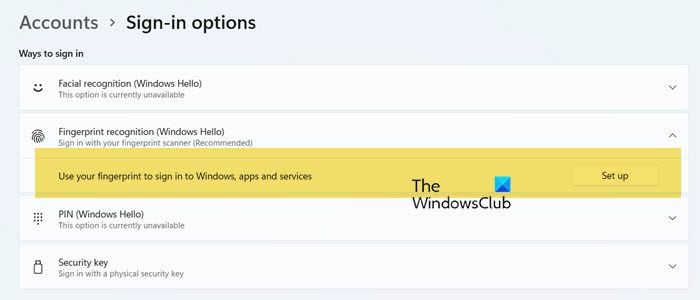

Set up the fingerprint reader
- Launch Settings
- Go to the Sign-in options from your Accounts Settings.
- Locate Windows Hello and select the Fingerprint recognition option.
- Select “Set Up”.
- Place your finger on the fingerprint ID sensor on your Surface Pro type cover. You can select one or multiple fingers to be read by the scanner.
- You will get a notification when the setup is done.
- Log in with your touch and enjoy the awesome experience of Surface Pro.
