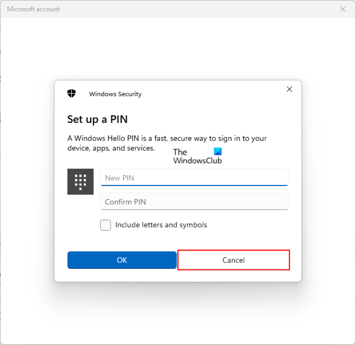

- On the Sign-in options page, expand the PIN (Windows Hello) tab, and click on the I Forgot my PIN link. After that, you will be prompted to reset your Windows Hello PIN. Click Continue.
- Now, Windows will ask you to confirm your identity by entering your Microsoft account password. After entering the password, you will be prompted to set up a new PIN.
- You need not set up a new PIN. Simply click Cancel and close the PIN reset window. This will delete your existing Windows Hello PIN from your computer.
