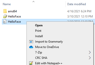

1] Install Windows HelloFace.inf file
If you accidentally uninstalled the Biometric device from Device Manager, installing the HelloFace.inf file can restore it.
The steps to do so are listed below:
- Open File Explorer.
- Copy the following path and paste it into the File Explorer’s address bar.
C:\Windows\System32\WinBioPlugIns\FaceDriver
- There you will find HelloFace.inf file.
- Right-click on the file and click Install.
- Follow the on-screen instructions.
- Restart your system after the installation process gets completed and see if the Biometric device is restored in the Device Manager or not.
