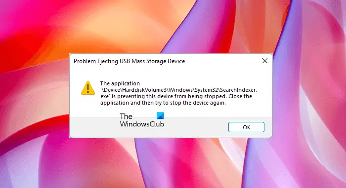

Safely Remove Hardware is a useful feature in Windows operating systems that lets users disconnect their external storage devices safely. To use this feature, right-click on your storage device in the File Explorer and select Eject. The same option is also available in the System Tray. If your USB device is in use, you will receive a warning message when ejecting it. But some users are getting the warning message even when their USB device is not busy. According to them, whenever they eject their USB device, the The application SearchIndexer.exe is preventing this device from being stopped message pops up on their screens.
The complete message is as follows:
The ‘application\device\harddiskvolume3\windows\system32\searchindexer.exe’ is preventing this device from being stopped. Close the application and then try to stop the device again.

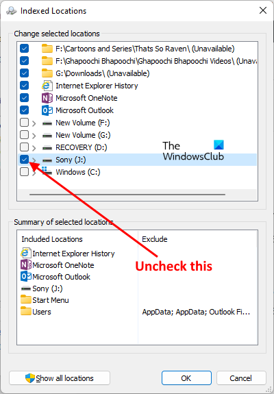

2] Disable Search Indexing on your external storage device
It is clear from the error message that the problem is caused by Windows Search Indexing. Therefore, disabling the Search Indexing on the external device can fix the problem. Check if Search Indexing is enabled for your USB storage device. If yes, disable it. The following instructions will guide you on this.
- Click Windows Search and type Indexing Options.
- Select Indexing Options from the search results.
- Check if your USB storage device is listed under Included Locations on the Indexing Options window. If yes, you have to remove it.
- Click Modify and uncheck the checkbox for your USB storage device.
- Click OK.
After that, you will see Windows start indexing the files. Wait till the Indexing gets completed. After that, close the Indexing Options window and eject your USB storage device.

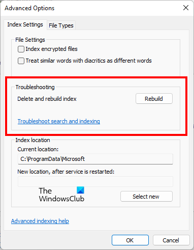

3] Rebuild Search Index
If the above methods did not solve your problem, rebuilding the Search Index should work. I also experienced this issue on my PC while ejecting the Sony Pendrive and I was able to fix it by rebuilding the Search Index.
The steps to rebuild Search Index are as follows:
- Launch Indexing Options window by typing indexing options in Windows Search.
- Click Advanced. The Advanced Options window will appear.
- Now, click on the Rebuild button.
- Click OK in the confirmation box.
The rebuilding Search Index will take some time. When the process gets completed, you will receive the Indexing complete message on the Indexing Options window.
After the rebuild is complete, you will be able to eject your external device.

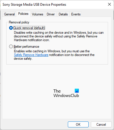

4] Change Device Removal Policy
If none of the above methods work for you, change the Device Removal Policy so that you will remove it without using the Safely Remove Hardware feature. The following instructions will guide you on this:
- Press Win + R keys to launch the Run command box.
- Type
diskmgmt.mscand click OK. This will launch the Disk Management app. - Right-click on your USB storage device and select Properties.
- Select the Policies tab.
- Select the Quick Removal option and click OK.
The Quick Removal policy manages storage operations so that users can remove their storage devices at any time without using the Safely Remove Hardware feature.
