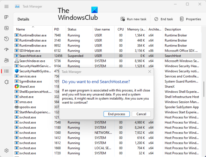

5] Restart SearchHost.exe using Task Manager
SearchHost.exe is a process used to search and index files on a Windows computer. Now, if Windows Search is not working properly or keeps crashing, you can try restarting this process and see if it helps. Here’s how you can do that:
- Firstly, hit the Ctrl+Shift+Esc hotkey on your keyboard to open Task Manager.
- Now, go to the Details tab and look for SearchHost.exe.
- Next, right-click on the SearchHost.exe process and click on the End task option.
- After that, press the End process button in the confirmation prompt.
- Once done, try opening Windows search and see if it has stopped crashing or not.

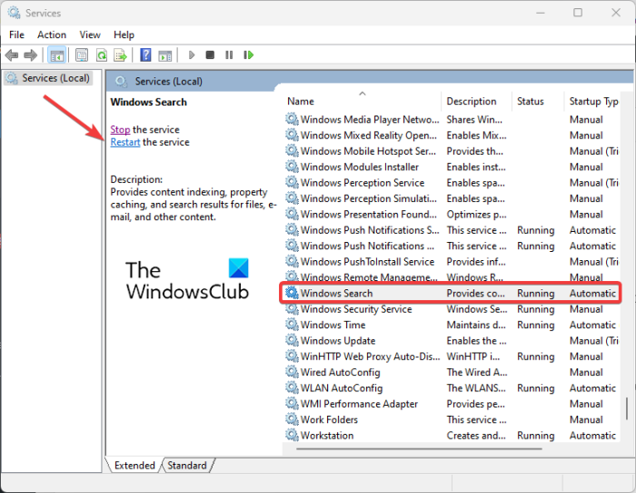

6] Restart the Windows Search service
There might be some issue with the Windows Search service or it might be stuck in a limbo state. As a result, the search bar keeps crashing or Windows search stops working properly. Hence, if the scenario applies, you can restart the Windows Search service to fix the problem at hand. Here’s how:
- Firstly, press Win+R to evoke Run and enter services.msc in the Open field to launch the Services window.
- Now, scroll down and locate the Windows Search service, and select it.
- After that, click on the Restart option to restart the Windows Search service.
- Once done, open the search and see if it works fine or not.

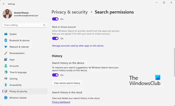

7] Delete Search History
You can also try deleting your search history and check if it resolves the issue for you. There might be some corrupted entries in the search history. So, clear the search history and then check if the Search function is working properly. You can follow the below steps to do that:
- First, launch Settings and move to the Privacy & security tab.
- Next, press the Search permissions option.
- After that, under the History section, press the Clear device search history button.
- Also, make sure the Search history on this device toggle is switched on.
- Now, try performing a search and see if the problem is resolved or not.

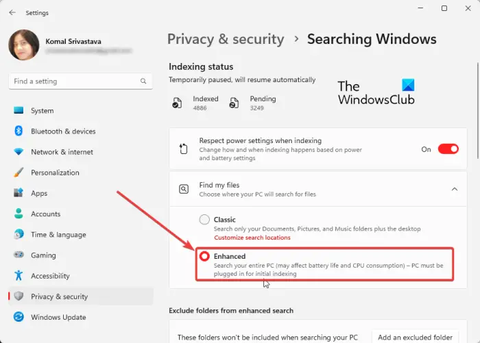

9] Enable Enhanced Indexing
You can also activate Enhanced Indexing to fix the problem. In the Enhanced search indexing mode, its searches through your entire computer. If you enable it, the search function might start working properly for you. So, do try this and see if it helps.
Here are the steps to enable Enhanced Indexing on Windows 11/10:
- Firstly, open Settings and click on the Privacy & security tab.
- Now, press the Searching Windows option.
- On the next page, select the Enhanced mode under the Find my files section.
- After that, make sure the folders you want to search are not listed under the “Exclude folders from enhanced search” section.
- Finally, see if the problem at hand is fixed or not.

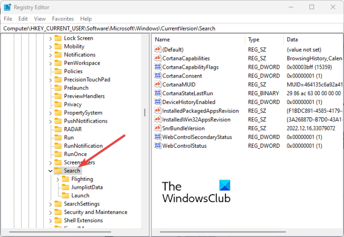

10] Delete corrupted Registry entry for Search
If nothing worked for you, you could try deleting the registry entries for Windows Search. The registry keys might be got corrupted which is why the Windows search function is not working correctly. Hence, you can delete the key and then see if the problem is resolved.
Note: We usually don’t recommend tweaking your Registry as it can cause serious issues to your PC. However, if the problem is not getting fixed even after trying everything else, you can try deleting the corrupted entries to fix the issue. But before that, make sure to create a backup of your Registry to be on the safer side.
You can follow the below steps to delete Registry entries for Search:
First, open Registry Editor and then go to the following address:
HKEY_CURRENT_USER\SOFTWARE\Microsoft\Windows\CurrentVersion\Search
Now, select the Search key, then go to the File > Export option, and save the key with the Search name on your desktop or some other safe location. In case something goes wrong, you can import the Search key.
Next, right-click on the Search key and choose the Delete option.
Once done, restart your computer and perform a search to see if it works fine or not.
