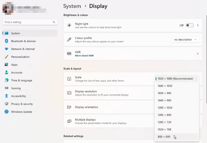

Change the display resolution. Open Windows 11 Settings and select System > Display. Now, select the Recommended option in Display Resolution and Scale. You can also try other display resolutions and see which one works for you.
Also, try changing the display refresh rate. Go to System > Display > Advanced display in Windows 11 Settings to change the display refresh rate.

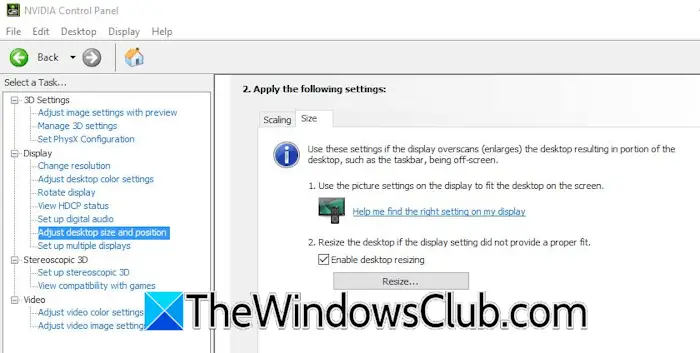

Open the NVIDIA Control Panel and expand the Display branch on the left side. Now, select the Adjust Desktop size and position option. Select the Size tab. Now, select the Enable desktop resizing checkbox and click on the Resize button. Adjust the Display to fit it to your screen.

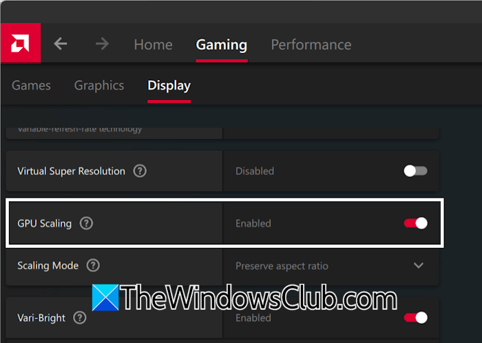

Users with AMD graphics need to follow the steps provided below:
- Open AMD Software Adrenalin Edition.
- Select the Gaming tab and then select the Display tab.
- Turn on the GPU Scaling button.
