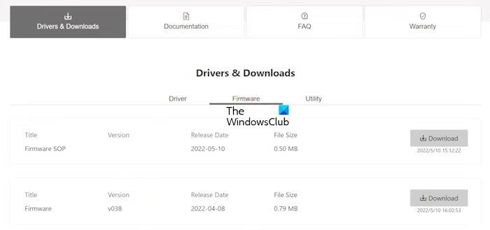

- Visit the official website of MSI and enter your monitor model number to download its latest firmware version.
- Now, download the following:
- Monitor firmware. You will find it under the Firmware tab.
- The Gaming OSD app. It is available under the Utility tab.

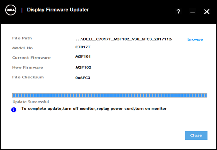

Now, connect your monitor to your computer with a USB Upstream cable. Run the Dell Firmware Updater application. The application will check for updates and install the same (if available). After the completion of the update, you will see the Update Successful message and the following message:
To complete update, turn off monitor, replug power cord, turn on monitor
Now, turn off the monitor and disconnect the power cable. Wait for up to 5 seconds, connect the power cable, and turn on your monitor. Your monitor has been updated to the latest firmware version.

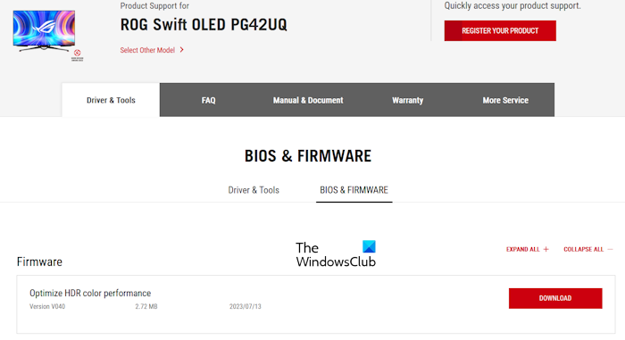

- Visit the official website of ASUS and enter your ROG Series monitor model number.

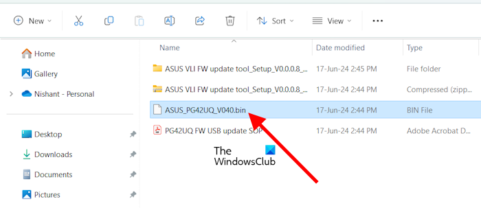

- Download the correct software for your ASUS monitor. The software will be available under the BIOS & FIRMWARE tab on the ASUS website.
- The file will be downloaded as a zip file. Extract the zip folder and open the extracted folder.
- You will find a setup file called the ASUS VLI FW Update Tool. Run this file to install your system’s ASUS VLI FW Update Tool.

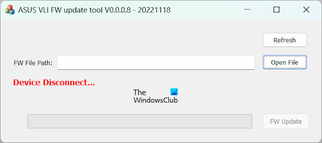

Connect the cables correctly to your monitor and your PC or laptop. Turn on your monitor. On your PC or laptop, run the ASUS VLI FW update tool. Make sure that your monitor is connected; otherwise, you will see the Device Disconnect message on the tool.
Click on the Open File button and select the firmware file from your PC. The file is located inside the folder you downloaded from the official website of ASUS (refer to the above screenshot).
After selecting the file, click on the FW Update button to begin the update process. When the update process is completed, reset your ASUS monitor to the factory default settings. Restart the monitor if required.

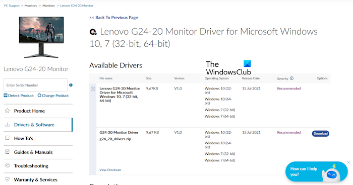

4] Lenovo Monitor
To install the firmware update on your Lenovo monitor, you will need a DisplayPort cable or the cable mentioned on the official website of Lenovo for your monitor.
Go through the following instructions.
- Visit the official website of Lenovo and search for your monitor by entering its model number.
- Download the driver of your monitor. The file will be downloaded in zip format.
- Extract the zip folder.
- Now, open the Device Manager and expand the Monitors branch.
- Make sure that your monitor is connected to your computer—Double-click on your monitor driver to open its Properties.
- Go to the Driver tab and click on the Update driver option.
- Click Browser my computer for drivers.
- Now, click Let me pick from a list of available drivers on my computer.

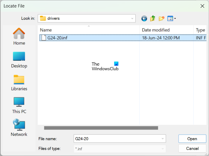

- Click Have Disk.
- Click on the Browser button button and select the INF file of your monitor driver.
- Click Next and follow the on-screen prompts to install the monitor driver.
Your screen may go black during the update process. After the installation process is completed, delete all the downloaded files and restart your computer.
