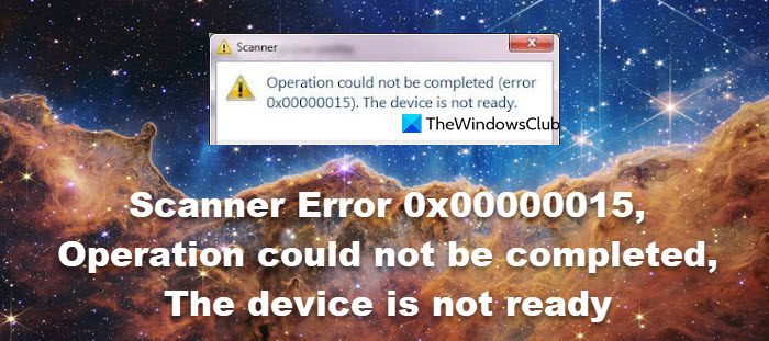

When trying to scan a document using our scanner, we get Scanner Error 0x00000015. Due to this, our scanner is unable to process the required document and we get the error in question. In this post, we will see what you can do if your scanner says “Operation could not be completed, The device is not ready” and throws Scanner Error 0x00000015.
Fix Scanner Error 0x00000015, Operation could not be completed, The device is not ready
If you get Scanner Error 0x00000015 and the operation cannot be completed because the device is not ready, on your Windows computer, follow the solutions mentioned below to resolve the issue.

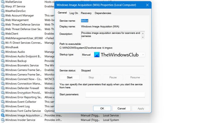

2] Check the status of the Windows Image Acquisition (WIA) Driver
Windows Image Acquisition (WIA) allows communication between your scanner and computer. When the service is disabled or has some glitches, you might encounter issues such as the one in question. In this solution, we need to check its status and ensure it’s running fine. For the follow the steps mentioned below.
- Open Services app.
- Now, go to the Windows Image Acquisition (WIA) service.
- Right-click on it and click on Properties.
- If it’s stopped, click on the Start button, if it’s already running, click on Stop and then select Start.
- Also, make sure to change the Startup type to Automatic.
- Finally, click on Apply > Ok.
Hopefully, this will do the trick for you.

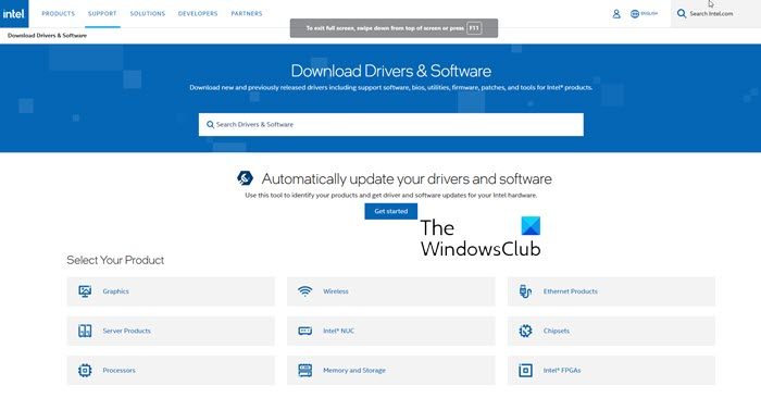

3] Install or update your scanner drivers
As you may already know, drivers are the piece of software responsible for interacting with your system’s hardware. If they are missing or are outdated, your computer will not be able to detect their presence and will stop responding. To resolve the issue, we need to install the latest version of your driver. Follow the methods mentioned below to do the same.
- Install the latest version of the driver from the manufacturer’s website.
- Download a free driver update software to keep your device updated.
- Update your scanner driver using the Device Manager utility.
After installing the latest version of the driver, you can reboot your computer and check if the issue is resolved.
