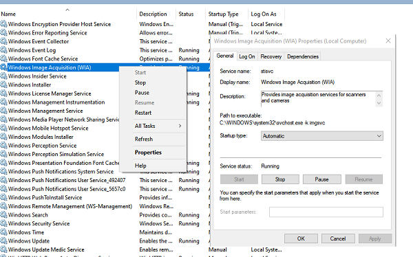

3] Restart the Windows Image Acquisition (WIA) Service
We have already talked about the WIA service, and it would be a good idea to restart it, too.
- In the Run prompt, type services.msc and press the Enter key.
- Loca WIA service. The description should say, “Provides image acquisition services for scanners and cameras.”
- Double-click to open, and then click on the Stop button and later on the Start button.
- You can also right-click on the service, and choose Restart from the context menu.
