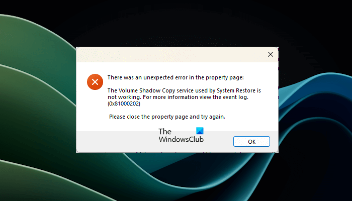

The Volume Shadow Copies are also used to create system restore points. Hence, we suggest you check the status of this service. To check the impact of Volume Shadow Copy Service on System restore, I disabled it and then tried to create a System Restore Point. I received the following error message:
The Volume Shadow Copy services used by System Restore is not working. For more information, view the event log.
(0x81000202)

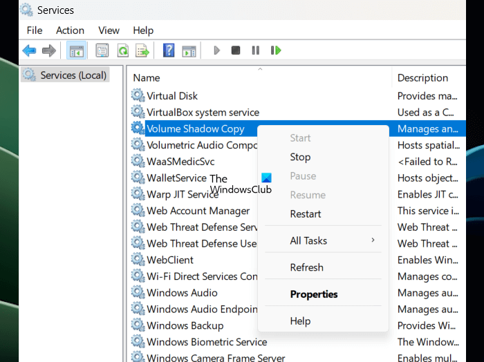

Check the status of the Volume Shadow Copy service. The following steps will help you do so.
- Open the Services Manager.
- Look for the Volume Shadow Copy service.
- Once you find it, right-click on it and select Start. If it is already running, select Restart.
If you see its Startup type Disabled, you cannot start or restart it until you enable it again. In this case, double-click on it to open its Properties. Under the General tab, select Manual in the Startup type drop-down. Click Apply and then click OK. Now, you can start it.

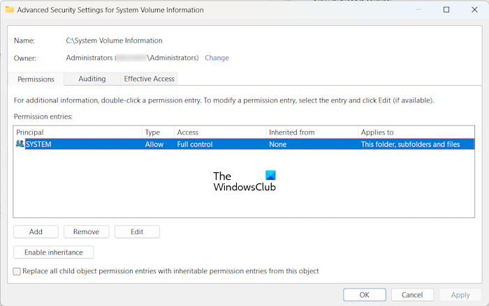

5] Check the permissions of the System Volume Information folder
The System Volume Information folder stores data related to system recovery, indexing, etc. System Restore uses this folder to save the restore points. It is a protected folder. That’s why it remains hidden by default, even if you enable the hidden files and folders option.

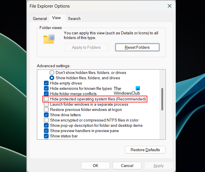

If Windows displays the Access Denied error while creating the system restore point, check the permissions of the System Volume Information folder. To view the System Volume Information folder, you must change the File Explorer Options.
- Click on Windows Search and type File Explorer Options.
- Click on the View tab and uncheck the Hide protected operating system files (recommended) option.
Now, you can check its permissions. It should show Full control permission for SYSTEM. If not, change its permissions to Full control for SYSTEM. Now, you should be able to create the restore point. When you are done, do not forget to hide the protected folders again.

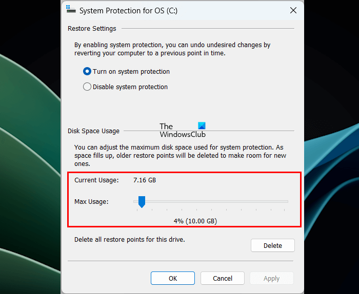

7] Increase the maximum disk space for System Restore
Windows allows you to set maximum disk usage by System Restore. When the set limit is exceeded, Windows automatically deletes the old restore points to create space for the new restore points.
You can give this fix a try. Increase the disk space for System Restore and create the restore point. See if it helps.

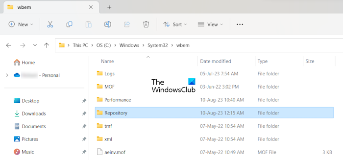

9] Reset the Repository
Reset the Repository by going through the following instructions:
Boot your computer in Safe Mode without networking and launch the Command Prompt as an administrator. Type the following command and hit Enter.
net stop winmgmt
The above command will stop the Windows Management Instrumentation Service. Now, go to the following location and rename the Repository folder to Repositoryold.
C:\Windows\System32\wbem
Restart your computer and launch the Command Prompt as an administrator. Type the following command one by one and hit Enter after typing each of the following commands:
net stop winmgmt winmgmt /resetRepository
Restart your computer and see if you can create the restore point this time or not.
