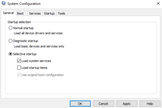

2] Press Win + R to open the Run windows and type ‘msconfig.exe’ and press ‘ENTER’ to access System Configuration Utility.
3] If the system asks for admin password, feed in the password and click ‘OK’ or ‘Continue’.
4] Find ‘Selective Startup’ in the ‘General’ tab and click it.
5] Uncheck the ‘Load startup items’ checkbox and click on Apply to save the settings.

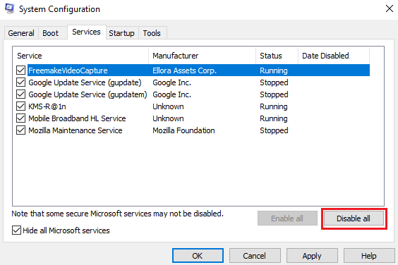

6] Now go to the ‘Services’ tab and select the ‘Hide all Microsoft services’ checkbox.
7] You will see the ‘Disable all’ option. Click it and then click ‘OK’. This disables all “non-Microsoft” services on the system.
