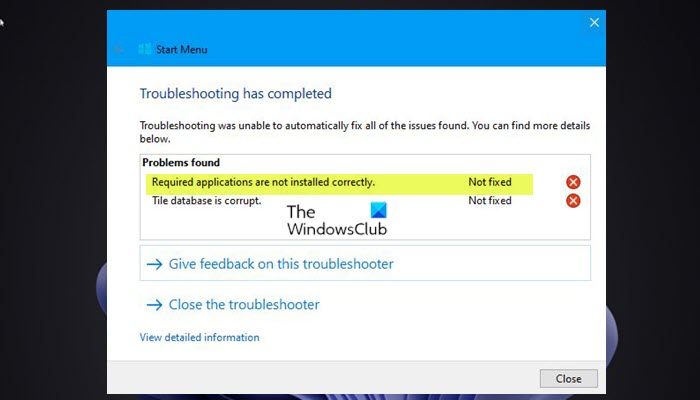

If you are experiencing Start Menu issues like Start menu not working or opening or Start menu freezes or not responding or Start Menu keeps popping up or opens randomly on your Windows 11 or Windows 10 computer, and you run the Start Menu Troubleshooter and receive the error Required applications are not installed correctly, then this post is intended to help you with the most suitable solutions to resolve this issue.
Required applications are not installed correctly – Windows Start Menu
If the Start Menu Troubleshooter displays error Required applications are not installed correctly in Windows 11/10, here’s what you need to do to resolve the issue on your system.

1] Re-register Start Menu
You can begin troubleshooting to fix the Required applications are not installed correctly issue on your Windows 11/10 system by re-registering the Start menu. To do this, follow the instructions in the guide on how to fix Windows 10 Start Menu corrupted – Tile Database is corrupt. You can also use our freeware FixWin to resolve Start menu issues as well as apps that are incorrectly installed on your PC.
Proceed with the next solution if this task didn’t work for you.
Related: Tile database is corrupt message in Troubleshooter.
