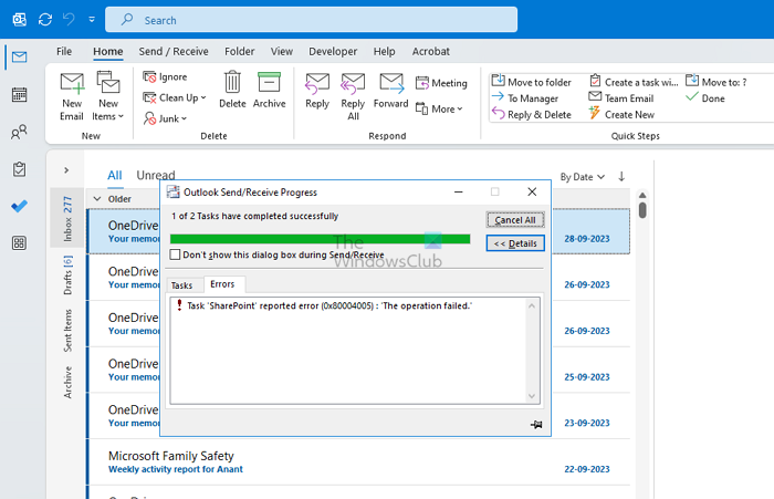

If you are receiving Outlook Error 0x80004005, The operation failed and ar looking for a solution, you are in the right place. The accompanying error message could be Failed to upload attachments to server, Task SharePoint reported error or Task RSS reported error. While the error primarily occurs because of script blocking by third-party apps, the issue has occurred in a couple of more places.

If you receive Error 0x80004005, The Operation Failed during Send/Recieve operation in Outlook, then it could be a script blocking issue, Mailbox Size Limit, etc. These are some of the methods that can resolve error 0x80004005 in Outlook based on the situation.

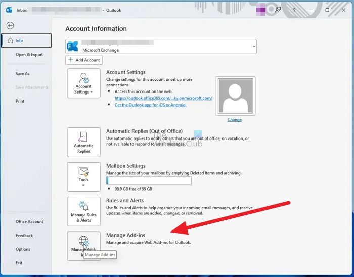

2] Disable add-ins in Safe mode
Sometimes, the Outlook 0x80004005 error might happen due to the Add-ins. In such cases, we recommend disabling the Add-ins in safe mode.
- Right-click Windows’s Start button (lower-left corner), and click Run.
- In the Run box, type outlook /safe and click the OK button to open Outlook in Safe mode.
- Now, in Outlook, click on File > Manage Add-ins.
- Under Manage add-ins, in the Turned on column, uncheck the box for the add-in you want to turn off.
Now, carry out the Send/Receive operation and check whether the error is resolved. If the error persists, try disabling another add-on and repeat the check. In case none of these work, move on to the next solution.

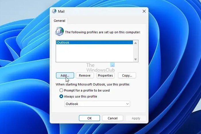

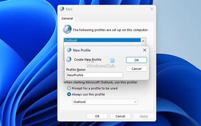

6] Create a new Outlook Profile
A damaged outlook profile usually occurs with the 0x80004005 error. In such a case, we recommend creating a new Outlook profile. Let’s find out how you can create a new Outlook profile.
- Open the Control Panel, find out for Mail, and click on it.
- Now, it will open a new window with three sections; you must click on the Show Profiles… option from the profile section.
- Click on the Add… button to add a new profile.
- Name it NewProfile and then click OK.
- Complete the account setup and then set NewProfile as your default profile.
After creating a new Outlook profile, check whether the error is resolved.
