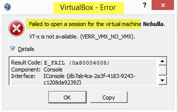

If VirtualBox is not starting the guest OS and it displays Failed to open session for the virtual machine, E_FAIL (0x80004005), follow this article to find the solution.
VT-x is not available (VERR_VMX_MO_VMX)
E_FAIL (0x80004005)
VirtualBox failed to open session for the virtual machine

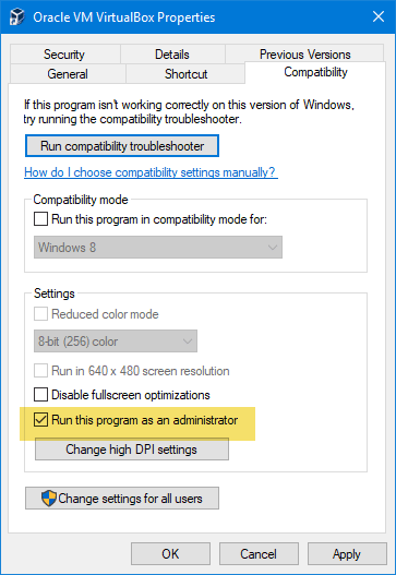

1] Open VirtualBox as administrator
Although administrator privileges are not mandatory by default, sometimes you might need to use them to fix this problem. If you have a desktop shortcut of VirtualBox and you use this shortcut to open this tool, you can right-click on the corresponding logo and select Run as administrator. However, if you want to give VirtualBox permanent admin permission, you need to follow these steps.
Right-click on the desktop shortcut and go to Properties. After that, switch to the Compatibility tab.
You should find a checkbox saying Run this program as an administrator here. Tick that checkbox and click the OK button to save the change.
However, if you do not have a desktop shortcut and you open VirtualBox from the Start menu, you can do this: Search for VirtualBox, right-click on the exact search result, and select Run as administrator.
Also, if you want to give admin permission to this Start menu button, the following steps will help you. Search for VirtualBox in the Taskbar search box, and select Open file location. Basically, you need to open the Startup folder in Windows computer and go to Oracle VM VirtualBox.
After that, right-click on the Oracle VM VirtualBox icon, and go to Properties > Compatibility tab and select the Run this program as an administrator checkbox.
After doing this, you should not get the problem as mentioned earlier.
