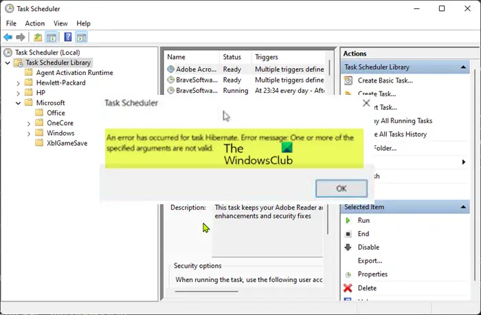

You may get a Task Scheduler error prompt stating One or more of the specified arguments are not valid if you have created an automated scheduled task that should be triggered or you have set some other conditions but it fails to do so when you log onto your Windows 11 or Windows 10 computer. This post provides applicable solutions to the issue.
An error has occurred for task [taskname]. Error message: One or more of the specified arguments are not valid.
When this error occurs on your system, it means that Task Scheduler is missing the required arguments that are needed to execute the task. This may be due to a certain group policy in effect, or that the task hasn’t been configured properly.
One or more of the specified arguments are not valid – Task Scheduler Error
If you get the One or more of the specified arguments are not valid error when a scheduled task fails to run on your Windows 11/10 device, you can try our recommended solutions below in no particular and see if that helps you resolve the issue on your system.

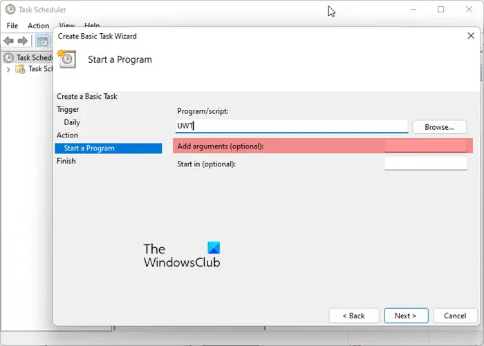

1] Check if the Task arguments are correct
- Open Task Scheduler
- Click on Action
- Selecet Create a Basic Task
- Under Action > Start a program, ensure that the arguments specified are valid.
