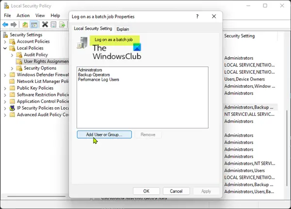

1] Add user to ‘Log on as a batch job’ group
The main culprit to the Task Scheduler failed to start – Event ID 101 on Windows 11/10 client machine or Windows server was revealed to be permissions-related. The applicable fix here is to simply add the user to the “Log on as a batch job” property on the server or client machine as the case may be. To perform this task, do the following:
- In the Run dialog box, type secpol.msc and hit Enter to oprn the Local Security Policy console.
- In the console, on the left navigation pane, click Local Policies to collapse the section.
- Now, click User Rights Assignment.
- On the right pane, double-click on Log on as a batch job policy to edit its properties.
- In the Properties window, click the Add User or Group button to add the appropriate username to the group.
- Finally, click Apply > OK to save changes.
- Exit Local Security Policy console.
Next time the job runs, it should run successfully without issues.

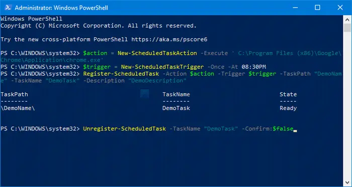

3] Delete and recreate the Task
Before you do this, you can try running the task manually in Task Scheduler and see if the job runs successfully. You can refresh the task history by pressing F5 or clicking the Refresh button. If it fails to run manually you can troubleshoot it from there until it does run manually. Otherwise this solution as a last-ditch effort requires you to delete the scheduled task if the task is not too complicated and then recreate the task from scratch.
