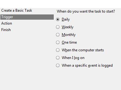

Step 5: From the Trigger, select the option you like and click Next.
I chose Daily and clicked Next, which brought me to this screen.

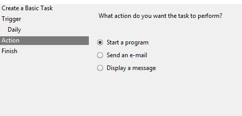

Step 6: Then click on Start a Program and click Next.

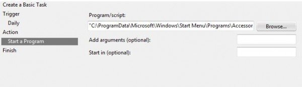

Step 7: Now click on Browser and select the batch file you would like to run.
Step 8: Finally, click on Finish to create the Task.

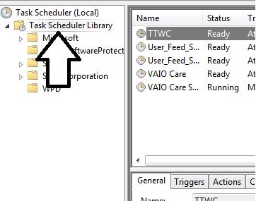

Now that we have created a Task, we must ensure it runs with the highest privilege. Since we have UAC settings, we have to make sure that it should not fail if it does not bypass the UAC settings when you run the file.
So click on Task Scheduler Library.
Then, double-click on the Task you just created.
Step 8: Click on Run with Highest privilege, then click OK.
