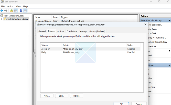

- Check the Triggers, Actions, or Conditions Tab for any wrong entries and click Edit to change them.

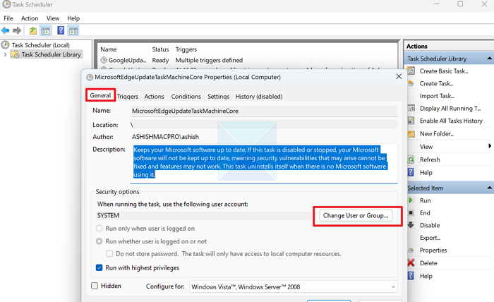

2] Assign relevant permissions
Since insufficient permissions can also cause the error, changing to the User or Group with admin rights for executing the tasks helps resolve the error. If the PC is part of a domain, the below steps can be followed to change the User or Group:

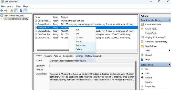

- Open the Task Scheduler and select the relevant task.
- Right-click on the task to open its Properties.
- Click on the General Tab under the Task.

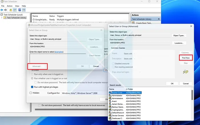

- Select Change User or Group under the Security Options section.
- Click Advanced > Find Now and search for the users within the domain with Admin rights.
- Changing to the local Admin Account or Group can fix the issue if the system is standalone.
- Select the User or Group and click OK.
- Also, check on the option that reads, Run whether user is logged in or not.
- Restart the PC and check if the error persists.

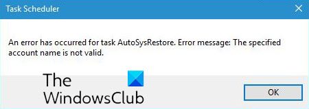

An error has occurred for the task: The specified account name is not valid
The error statement points to an execution error for a particular task due to user account-related issues.

- Right-click on the task and select the Properties

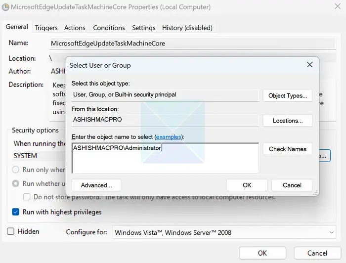

- On the Properties window, go to the General > Change User or Group to switch to a user with Admin rights.
Check whether the error appears once the new user details are entered.
3] Use Domain Path while specifying Username
Open the Task Scheduler and right-click on the specific task to select and open its Properties.
- Click on Change User or Group under the General Tab of the said task.
- Click the Advanced button to check for available usernames before selecting the concerned user. Once the user is selected, the correct username format, including the domain name, appears automatically.
- Click Apply and then OK to save the changes and check if the error persists.
If the PC is not part of any domain, enter the local username with admin rights under Change User or Group.

From Task Scheduler
- Right-click on the relevant task and click on Delete

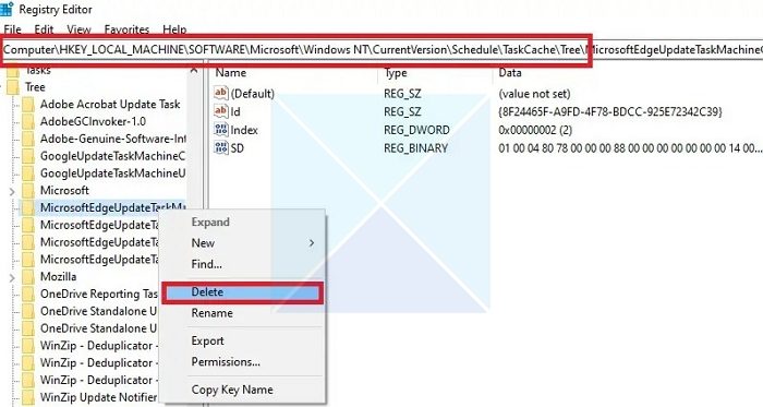

From Registry
- Open the Registry Editor by typing regedit in the Run Dialogue box
- Navigate to
HKEY_LOCAL_MACHINE\SOFTWARE\Microsoft\Windows\NT\CurrentVersion\Schedule\TaskCache\Tree
- Expand the Tree subkey and click on Task Folder
- Under Task Folder, right-click the concerned task folder and click Delete to remove the task.
It is highly recommended that a task folder should be deleted from the registry, even after it is deleted from the Task Scheduler. Windows sometimes fails to remove the registry entry for a task even though it has been deleted from the Scheduler. This can lead to conflicts when new tasks are created.

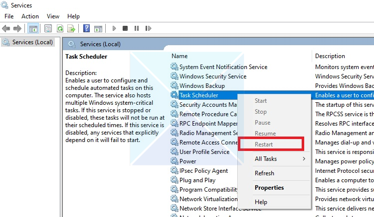

2] Restarting the Task Scheduler application or service
The above error might not be encountered for a single active task but multiple tasks in the Scheduler. The number of times this error is displayed matches precisely the number of tasks not synchronized with the Windows Registry.
For example, if the error appears twice, the same problem occurs for two currently active tasks in the scheduler. Similarly, three such errors mean it’s affecting three tasks.
However, once the error message occurs, the Task Scheduler will not display the task anymore. Hence, closing the Task Scheduler application or restarting the Task Scheduler service will clear out the task causing the problem. Once cleared, the task can be set from the beginning, and the error will no longer occur.
Note: Restarting the service reinitializes the task components in the scheduler application and the registry, helping the tasks to synchronize.
