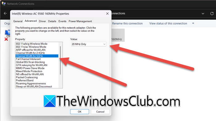

4] Change the channel width
Changing the network adapter width is recommended to optimize the connections for stability and compatibility. In some cases, a wider bandwidth may lead to interference, especially in environments with multiple devices or overlapping channels.
- Go to the Search bar, search, open Control Panel, and click on Network and Internet > Network and Sharing Centre
- Click on Change adapter settings, right-click on the wireless network adapter, and select Properties.
- Click on the Configure button, and navigate to the Advanced tab.
- In the Property section, select Channel Width for 5HZ, and then in the Value drop-down menu, select the 20MHz option.
- Hit the Ok button to save the changes, and quit the window.
Check if the Network Adapter is now working properly or not. If it is in the same condition, move to the next solution.

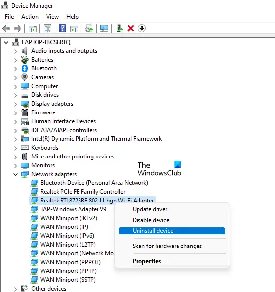

In case, updating is to no avail, follow the steps mentioned below to reinstall the driver.
- Navigate to the Start search box, type devmgmt.msc in, and hit Enter to open the Device Manager.
- Locate the Network Adapter drivers, expand the list, and right-click on it.
- Select Uninstall the device to remove the driver. Reboot your system to automatically install the driver.
In case, Windows installs a generic driver, you need to go to the manufacturer’s website to update it.
