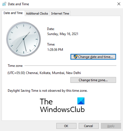

1] Set the correct date and time
Incorrect date and time also cause Microsoft Store apps to crash with exception code 0xc000027b. The bad timestamp causes Store requests to fail, preventing the Store’s server from establishing a connection. As a result, users experience Store and Store apps crashing. In this case, the issue can be solved by setting the correct date, time, and timezone.
Follow the below instructions to do so:
- Open the Run dialog, type
timedate.cpland click OK. - This will open the Time and Date window.
- Click on the Change date and time button. This will allow you to set the correct date and time.
- To change the time zone (if it is incorrect), click on the Change time zone button and select the time zone accordingly from the drop-down menu.
- When you are done, click Apply and then OK to save the settings.
Now, restart your computer and check whether the issue is solved or not.

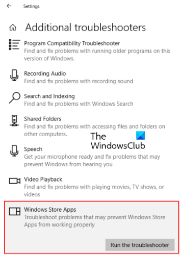

2] Run the Windows Store Apps Troubleshooter
Windows Apps Troubleshooter is a built-in tool that helps fix Microsoft Store apps problems. Run this tool and see if it helps.
Follow the steps listed below:
- Open the Settings app and click Update & Security.
- Select Troubleshoot from the left side and click Additional troubleshooters on the right pane.
- Scroll down the list and select Windows Store Apps.
- Click Run the troubleshooter.
