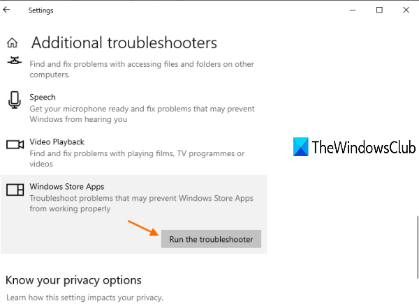

4] Run Windows Store Apps troubleshooter
There is a native Windows Store Apps troubleshooter that might work to resolve this issue. Here are the steps:
- Press Win+I hotkey to open the Settings app
- Select Update & Security category
- Click on the Troubleshoot page option available on the left side
- Use the Additional troubleshooters option available on the right part
- Click on the Windows Store Apps option
- Press Run the troubleshooter button.
Now, the troubleshooter will analyze whether the location of temporary internet files has changed, check app Registry keys, and provide possible fixes. This might help you sort out Microsoft error 0x80072F7D.
